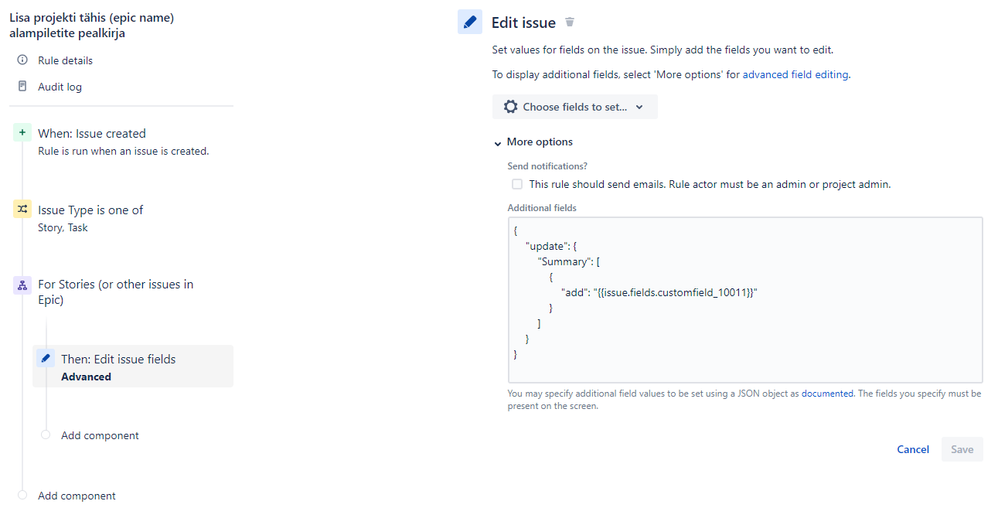

The goal is to set up an automation rule that would automatically copy "Epic name" value and add (not override) it to child issues' "Summary" field that are created to this Epic.
I have tried several configurations but end up nowhere. Current rule set up is:

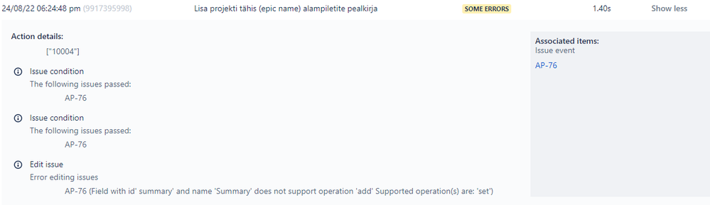

But I get an error saying that the operation "Add" is not supported for "Summary" field.
And according to the advanced field editing documentation the operation "set" would override any existing value.

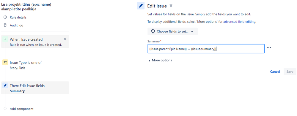

Finally, based upon your rule structure with a branch, you will want to get at the epic name using the parent smart value.  So to do what Jack suggests, please try this:
  • try using the field edit without the advanced edit with JSON in Additional Fields
  • instead, type/paste in this smart value:
    • {{issue.parent.Epic Name}} -- {{issue.summary}}
    • or...
    • {{issue.parent.summary}} -- {{issue.summary}}
  • the value will appear below the field, and then you may select it for use in the edit

The rule did not work with the branch so I removed it. Everything works as expected with both smart values that Bill suggested:
