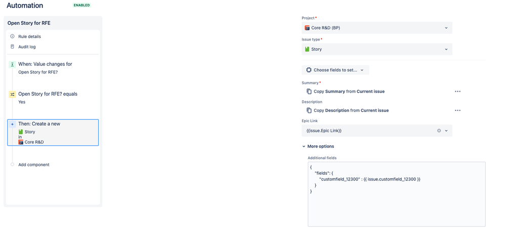

I would like to create an automation that once specific field is changed to Yes a new Story is created and the mandatory fields which are Epic Link and Team are copied from the triggered issue. I've succeeded with the Epic link but Team field is not found and I need to add a Json, I've tried few options but nothing works. Can someone please advise how the Json should look like? The example below is not working I'm getting the following: Error while parsing additional fields. Not valid JSON.
I've also tried  and it failed:
"fields": {
"customfield_12300" : issue.customfield_12300
But when I gave a specific team number it worked :
"fields": {
"customfield_12300": "39"

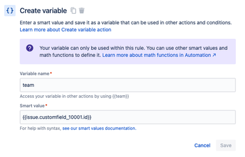

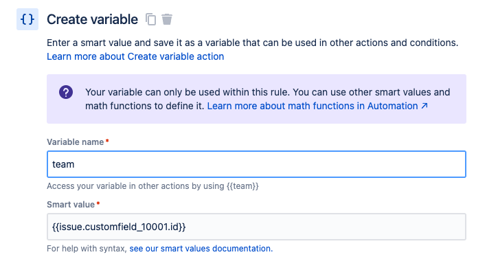

  1. Before creating an issue add the action: Re-fetch issue data
  2. Then add the action: Create Variable

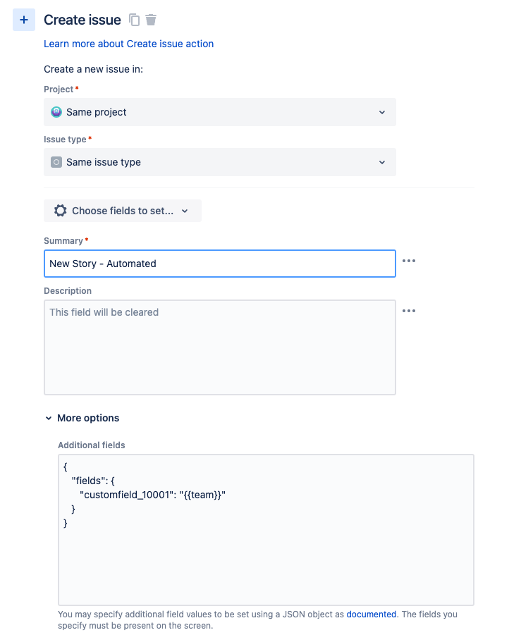

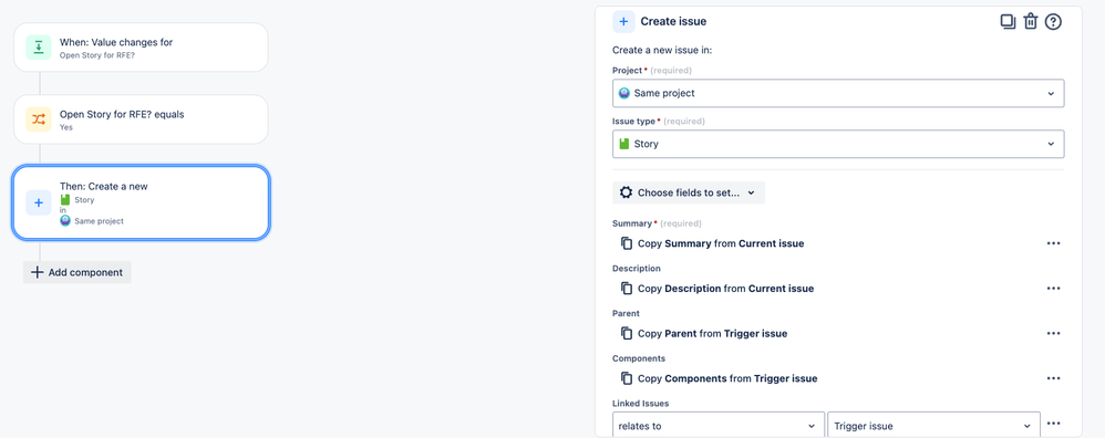

  3. Then create the issue and use the json

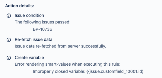

Sari Kachorovsky
August 30, 2023

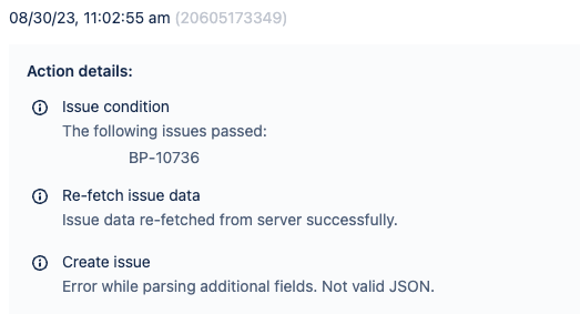

@Marc - Devoteam Thank Marc for your help, I've implemented your fix (beside that I've choose Story and not same issue type cuse they are different issue types) and I'm getting the attached error. Any idea why?image.pngimage.pngimage.png

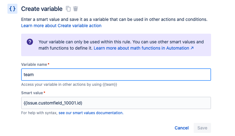

Hi @Sari Kachorovsky
You are missing a } at creating the variable.
The right input is:
{{issue.customfield_10001.id}}
Make sure that the Team field in you instance has the id 10001. I think it will as I think this is the default id value for field team.

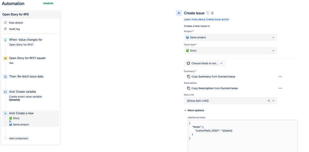

Sari Kachorovsky
August 30, 2023
@Marc - Devoteam opps u r right - I fixed it -but still getting the same error. I've tried also with customfield 12300 (cause it works for me for team in another automation) but still the same error.image.pngimage.png
I see you team field has the ID: customfield_12300 from your original post and there is an error in the json
You missed the closing quote " after "{{team}}
I think your json should look like this:
"fields":
"customfield_12300": "{{team}}"
Like Sari Kachorovsky likes this
Sari Kachorovsky
August 30, 2023
@Marc - Devoteam It's working!!! Thank you so much for your help!

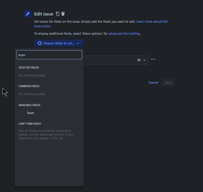

Collista Lewingdon
August 30, 2023
@Marc - Devoteam Well that is odd because I am able to access it in automation. And...even better....custom fields that I have created can be selected in Automation. Team.png

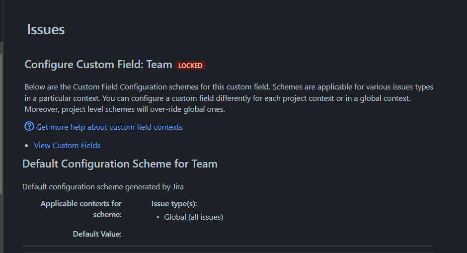

Collista Lewingdon
August 31, 2023
It is not a field that we created. It says it was generated by Jira and is locked for editing. TEAM FIELD.png
And it is the only field labeled Team in our instance of Jira.
