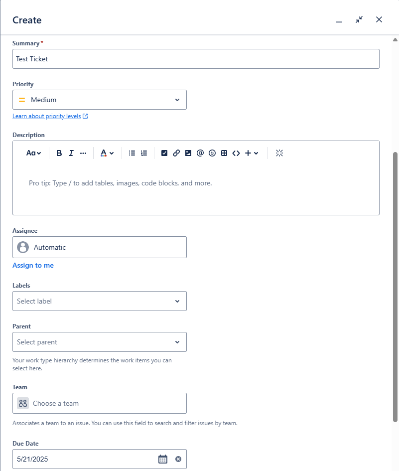

Hello,
I would like to add the due date to the front of the card view so that we can easily see it on our Kanban board without clicking into the ticket. However, I can't find anywhere to edit the card view of our team managed project. I have seen other similar posts however, when I navigate to my board settings, I do not see card layout as suggested in these posts; I'm guessing this is because these post are older and the UI has changed.
I have due date on my work items as shown below, but it does not appear on the card in the board view.

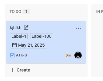

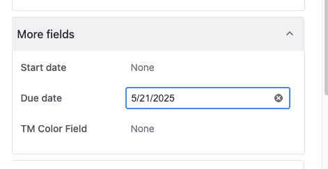

If you use the system supplied "Due date" field in your Team Managed project then the information will be automatically displayed on the card. It appears that you are actually using a custom field named "Due Date" instead.
Is it possible for you to consider using the system supplied "Due date" field instead, and migrating the values from your custom field to that native field?
Screenshot 2025-05-19 at 10.47.19 AM.pngScreenshot 2025-05-19 at 10.47.31 AM.png
Kathryn Klarich
May 20, 2025
Thanks for your response - I didn't realize we were using a custom due date field. I switched over to the System defined due date field and it works perfectly!
