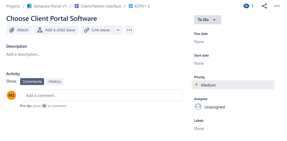

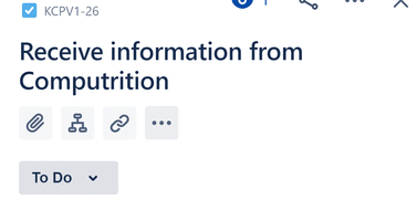

Here's is the parent with it's sub-task below that doesn't have the child button.
Sounds like the grandchildren are subtasks, which indeed cannot have their own subtasks.
Epic > Story (Issue) > Task (Subtask)

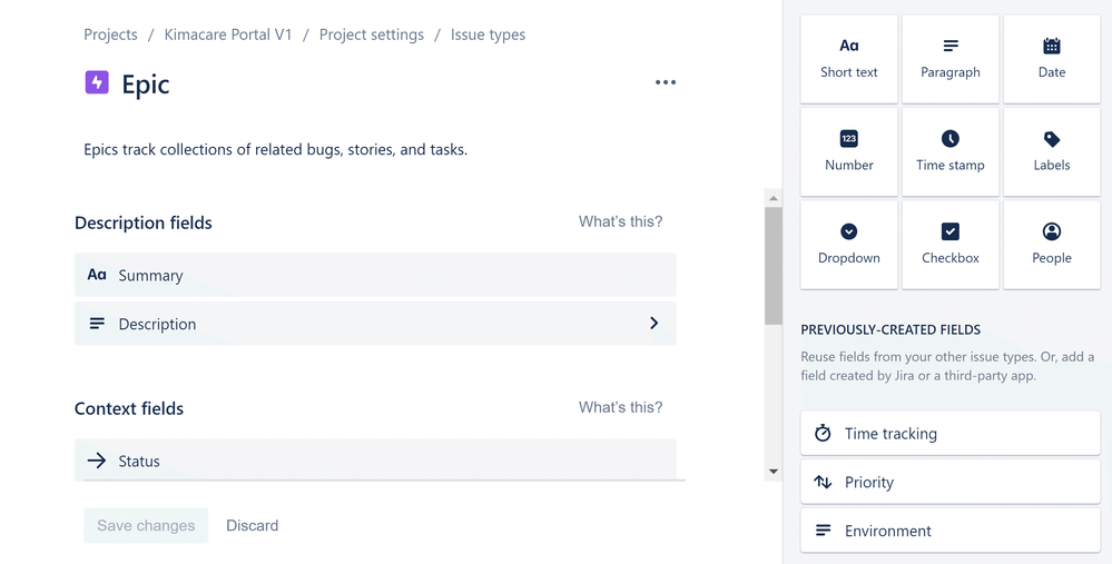

I don't see a components field. I took a look at the configure panel and there is no Off the shelf Components field. Is that because I am using the Kanban project template? Should I make a custom Components field. I prefer using out of the box if it exists so that I don't create confusion. Thoughts?
No need to create a new field - it will be there. You might need to add the Component field to the screen you are using. But you should also see Components listed on the left hand navigation while on a board.
You must be a Project Administrator to add new Components and Components are unique to each project. So if you want to use a particular Component across multiple projects, you have to add the same Component to each Project.

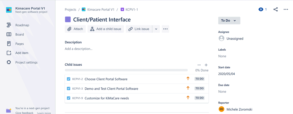

I still don't see it. I looked in Configure and on the boards themselves. Can you please point me to it. Here's what I see:
Ah, sorry - you are using a Next-gen project. So yes, you would need to create a new custom field for that.
But Next-gen projects use a different scheme for connecting to Epics so not real sure if all of that will work.
