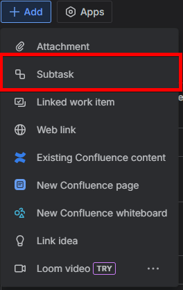

@George Bliss if your project is configured appropriately, you should be able click the "+ Add" button in any Task and select 'Subtask' (screenshot below for reference).
If you don't have this option it means either your project doesn't have the Sub-task issue type available, or your site hierarchy has been modified from the standard so that Sub-task does not fall under Task. Both of these issues can be answered/resolved by a Jira administrator for your site.

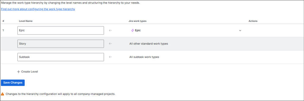

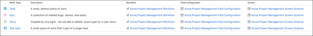

We have the issue type setup correctly:
The hierarchy looks fine also.

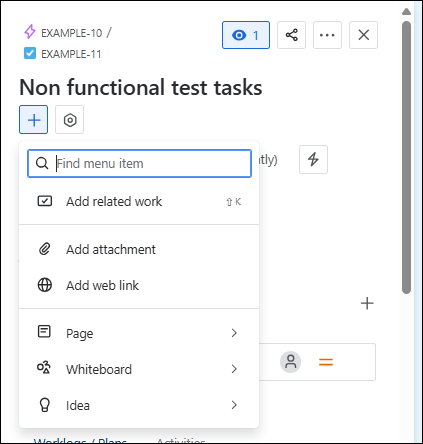

But I still can't see the option:
This is a project management template. I created a work management company managed project as I am a Jira admin. Let me know if I am missing something :)

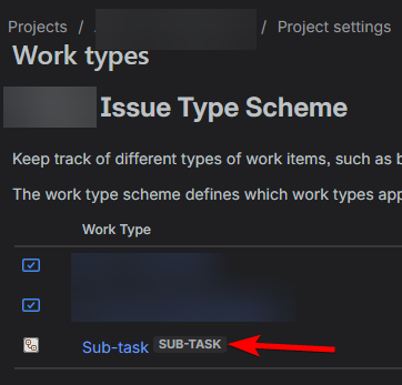

Hmm. Is the sub-task issue type using a workflow that has a create condition that could be preventing you from seeing it?
I just added a sub-task issue type to a business project in my sandbox environment and I was able to add a sub-task from the + menu without a problem.
One interesting note I found is that my Sub-Task issue type has a Sub-task label (screenshot below) denoting it as a -1 on the hierarchy. Your issue type (work type) list doesn't appear to have that label. It might be worth validating that the sub-task issue type you're using is, in fact , a sub-task type.

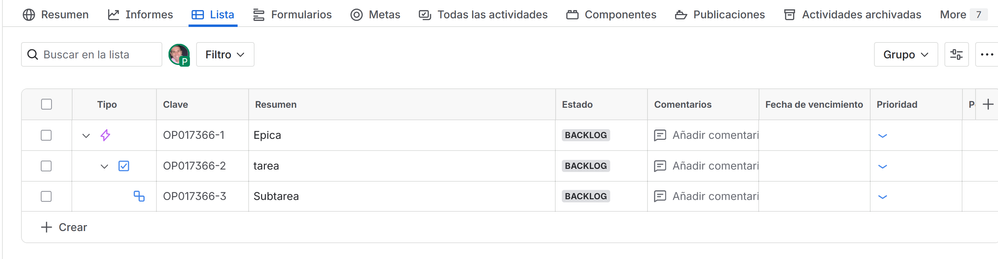

Hello @George Bliss ,
You could use the list view to see the hierarchy within a project:
Epic → Task → Subtask.
If what you want to see is a portfolio view of multiple projects with their tickets, you’ll need to use Plans.
