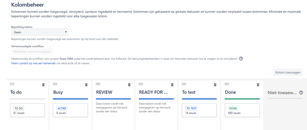

Deleted user
October 16, 2019
At the right side i miss a button for the status next to Kolom toevoegen
Jack Brickey
October 16, 2019
you won't always have a button to add a status from the board itself. that is available with simplified workflows. Edit your workflow and add the statuses you need and build the transitions as desired. Return to the board and you should have the statuses available to map.
