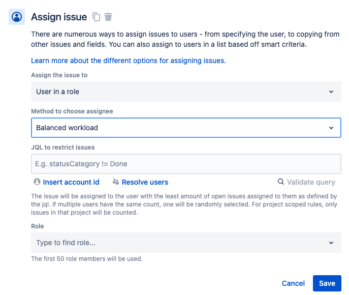

Hi @Fen_Stormon,
Welcome to Atlassian community!
The assign issue component in Automation can assign based on a project role, so you could use that. That would cover the case when the user is replaced, then all you would have to do is adding the new user to the correct role.

@Mikael Sandberg Thanks! Unfortunately this doesn't seem to work on a component that adds a subtask.

It should work on any issue type, including sub-tasks. If you do the assignment within the rule that creates the sub-task then you would need to use the related issue branch and select the most recent created issue. Note that if you have multiple sub-tasks that you create that should be assigned to the same user, I would either add a component (and in that case you could use component lead to assign instead of an automation) or a label that indicate who to assign it to. You could then remove the label once the issue was assigned.
