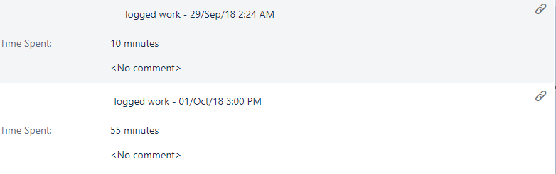

Thanks for the reply, but however that's not quite what I want. As an example, in below image, I want to get the time for each day that he worked on. So if i wanted to get the time he spent on for the OCT 1, it would be 55 mins. Rather than collection of all the he spent on that ticket.
Ohh, i see.
You can't do it in Jira jql.
You can script it with ScriptRunner or with rest api read all worklog.
I see, There's a pluging call TimeSheet on Jira market, I've been using it, However I want to write a script to do some specifics and take it further.
In it, it perfectly breakdown the time for each day. Do you have any idea how it has been done there ?
This plugin shows something they coded to extract the data and show it to you.
In order to do it your self you will have to code it, that's what i meant before when i said you will have to do some scripting.
I understand, currently i'm on the process of writing a perl script, I'm able to get the details about the tickets. but in the json i'm getting those details aren't available.
But however you just gave me an idea, how i can overcome this. Thank you :)
