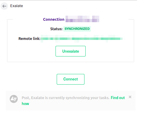

Right now, synchronized issues are displayed in the Exalate field inside each Jira issue. However, I’m not able to access this information programmatically. When I retrieve issue data via the Jira REST API, the Exalate field does not return the linked issue information or the URL of the synchronized issue.
One of the key requirements for this migration is not to lose the existing Exalate data. We need to extract the linked issues URL for each work item so that we can store them in a new custom field and continue using them in Jira Automations.
