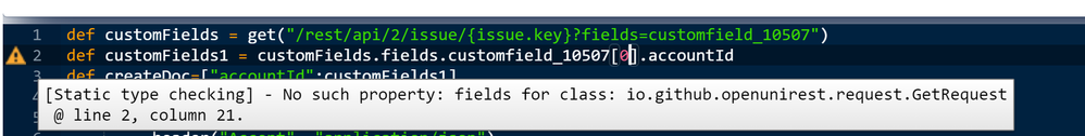

Rai, Jagrit
February 15, 2023
yes i tried in this way too but in post-function script runner it shows warning like thisquestion2.png
Jeroen Poismans
February 15, 2023
Ok, never mind the type error and lines ... Those are probanly there because of type checking.
I saw an error in my code, try something like this:
def customfields1 = customFields.fields.customfield_10507[0].accountId
Regards,
Jeroen

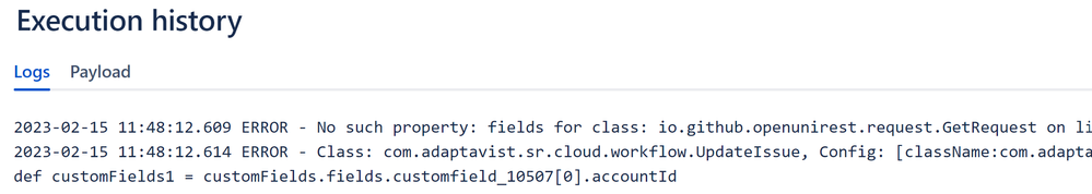

Rai, Jagrit
February 15, 2023
btw why you are accessing 0th index of array object however the approver field account id is at first index i think.
Jeroen Poismans
February 15, 2023
Hi,
Never mind the type checking warnings, try executing the code (maybe in script console with an example issue) and see what real errors come out of it then ...
Now, if you inspect the JSON from my first reply you will see that the customfield contains an array. Inside that array the first Approver object is at index 0, not 1.
Regards,
Jeroen

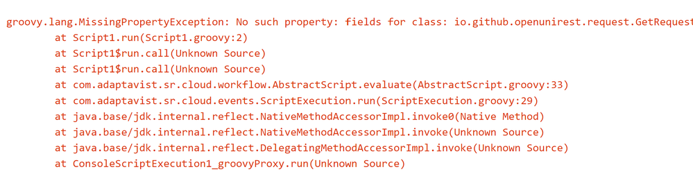

Rai, Jagrit
February 15, 2023
Jeroen Poismans
February 15, 2023
Hi,
Try this, this I have tested myself:
def result = get('/rest/api/2/issue/{issue.key}?fields=customfield_10507')
.header('Content-Type', 'application/json')
.asObject(Map)
if (result.status == 200){
return result.body.fields?.customfield_10507[0].accountId
} else {
return "Failed to find issue: Status: ${result.status} ${result.body}"
It's the part after the return statement that contains the data you want.
Regards,
Jeroen
