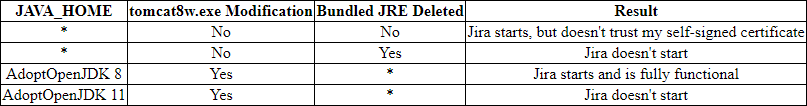

There are multiple observations I have made that would indicate the statement (paraphrased) "Setting the JAVA_HOME environment variable prevents Jira from using the bundled version of Java" is false.  They are:
1) If setting JAVA_HOME forced Jira to "not use internal Java shipped with it", then I should be able to delete the JRE directory installed with Jira, and Jira should run without issue.  That isn't the observed behavior.  Deleting the JRE directory within the Jira installation prevents Jira from starting up, even with JAVA_HOME set appropriately.
2) I generated self-signed certificates to secure our Jira/Bitbucket instances.  I have installed these certificates into the AdoptOpenJDK 11 trust store.  When I don't delete the JRE directory, and start Jira with JAVA_HOME pointing to the AdoptOpenJDK 11 installation directory, I get a bunch of certificate errors (specifically with application links between Bitbucket and Jira).  My assertion is that these errors are the result of Tomcat using the bundled JRE, which hasn't been setup to trust my self-signed certificates.  If I run the tomcat8w.exe command indicated in my original post using AdoptOpenJDK 8, Jira starts up and all application links work correctly.
3) Running the "tomcat8w.exe //ES//JIRASoftwareNNNNNNNNNNNN" command from the Jira installation reports that the configured JRE is something like "..\..\jre\bin\server\jvm.dll" (I can't see the actual value this was set to by the installer, because I have since changed it to point to an AdoptOpenJDK 8 path based on JAVA_HOME.  However, I know with certainty that this path was hard-coded to some relative path to the JRE bundled with Jira).
So, to summarize the observed behavior (note that * indicates any value)...
All of these observations support my assertion that tomcat is run using the bundled JRE, regardless of what JAVA_HOME is set to, unless you additionally run the tomcat8w.exe modification indicated in my original post.  If there is evidence to suggest otherwise, please present it here.
