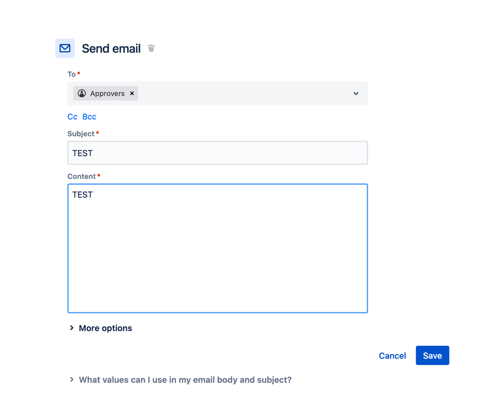

Maybe this is a silly question.. Why do you need to parse the emails that way? When I try to set up an email action automation rule, I can add the user picker in the recipients list without worrying about parsing.
