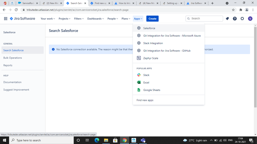

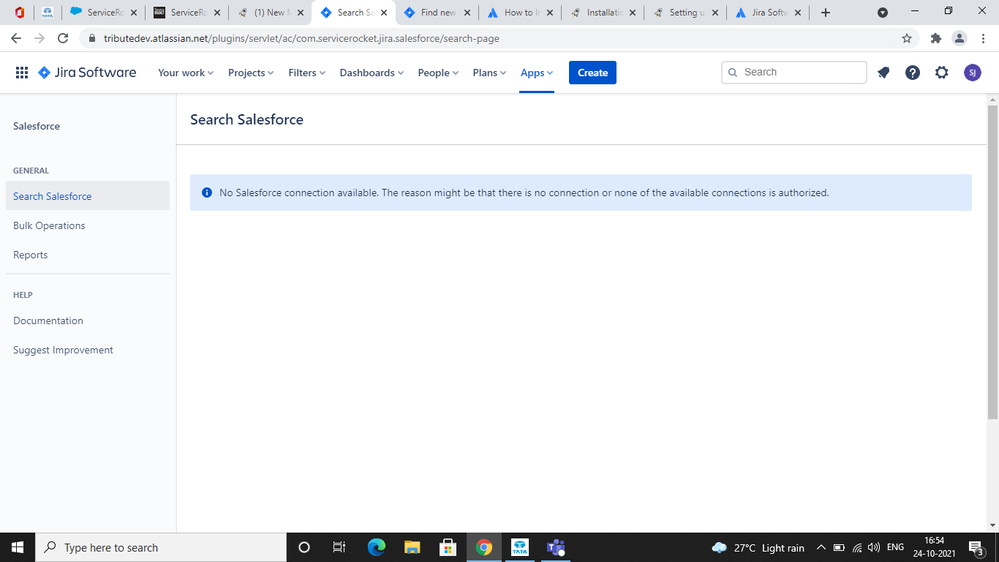

Saurabh Jain
October 24, 2021
Saurabh Jain
October 24, 2021
Hey Aaron,
As you can see in the attachment above, after installing the 'Connector for Salesforce and Jira' app in Jira still not able to seeing any options there. I had follow all the steps as mentioned in ServiceRocket site.   Screenshot (20).png

Saurabh Jain
October 24, 2021
Hi Jack,
I am using 'Connector for Salesforce and Jira' app. As you can see in the attachment after clicking on the salesforce app this error I am getting. Not seeing any options there. I was the following the steps mentioned in the site.Screenshot (19).png
