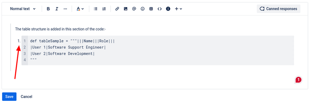

Hi,
I have a question about Jira cloud: How can I insert a code snippet into a quoted text without having a Numbered List automatically included?
This was doable on Jira DC, but it's a bit of a pain to do in Jira cloud. Every time I try to add this, I get a Number List on the outside like:
It would be great to know how this can be resolved.

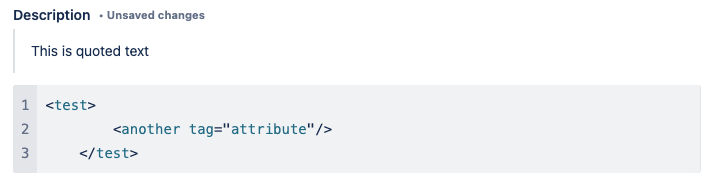

Hi @Ram Kumar Aravindakshan _Adaptavist_ welp, I could not replicate this at all. No numbered list showed up when I did the following:
Steps I tried:
  • Insert Quote
  • Insert Code snippet
Results:

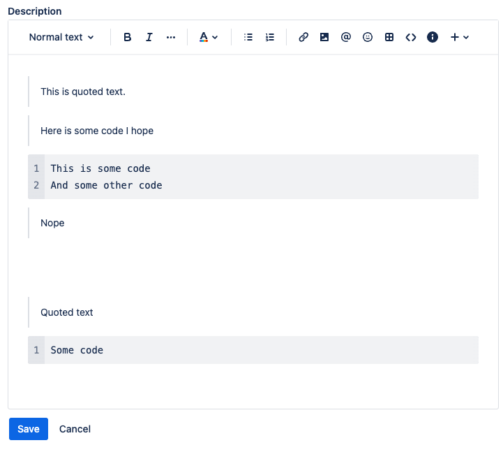

Hi @Darryl Lee
Since you have the code snippet below the quote, do the following:-
1. Go into the quote, press enter once,
2. Go to the last line of the quote and click the delete button to bring the code snippet into the quote.

Darryl Lee
May 16, 2024
Oh neat! It almost works! So yeah, the API is showing that it NESTED the codeBlock into an orderedList.
Now I wonder what this looks like in Automation...
HUH when I output {{issue.description}} to the audit log, I see:
{quote}Here is some code I hope # {code:none}This is some code And some other code{code} Nope{quote}
SOOOOO... yeah, I dunno. That looks very similar to what I tried to add via automation (without any spaces), except for the addition of the #.
Definitely a bug, I reckon.

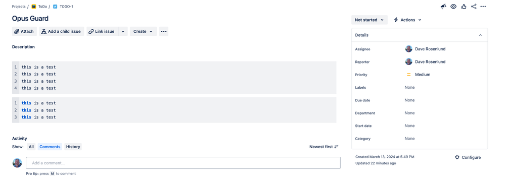

For some reason, @Ram Kumar Aravindakshan _Adaptavist_, I cannot reproduce this (unless I format the snippet as a numbered list).

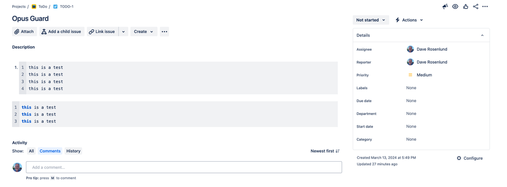

Dave Rosenlund _Trundl_
May 16, 2024
Wait!  I just did another test. Once I added the numbered list format to the snippet, I could not turn it off.
However, I could copy the contents of the snippet; delete the snippet; create a new snippet block; and paste the copied text into it.
No more number outside the box.

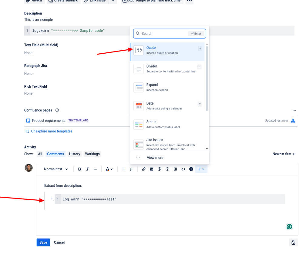

Could you try to repeat that test, this time try to add the code snippet into a Quote,  as shown in the image below:-
Thank you and Kind regards,
Ram
May 16, 2024
Thanks, @Ram Kumar Aravindakshan _Adaptavist_. Some how I was missing the "inside a quote" piece of this. I can reproduce now and I can find no workaround.
I think you discovered a bug 😱
