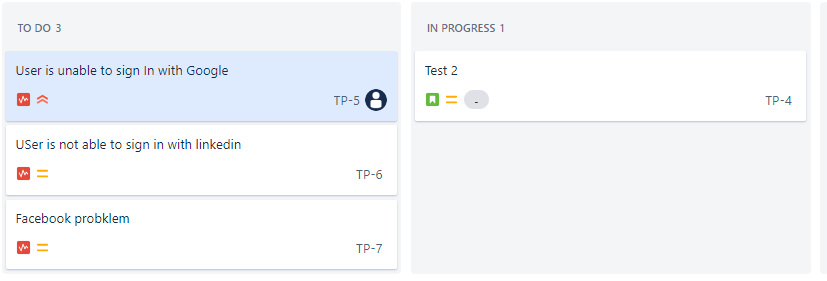

So the issue that I'm facing that I have created custom issue type called "Test Case Bug" and link them to already created User Story as well. What I don't want is that those custom created issues shouldn't be shown on the board. Let me show you the Board View:
Pic 1:

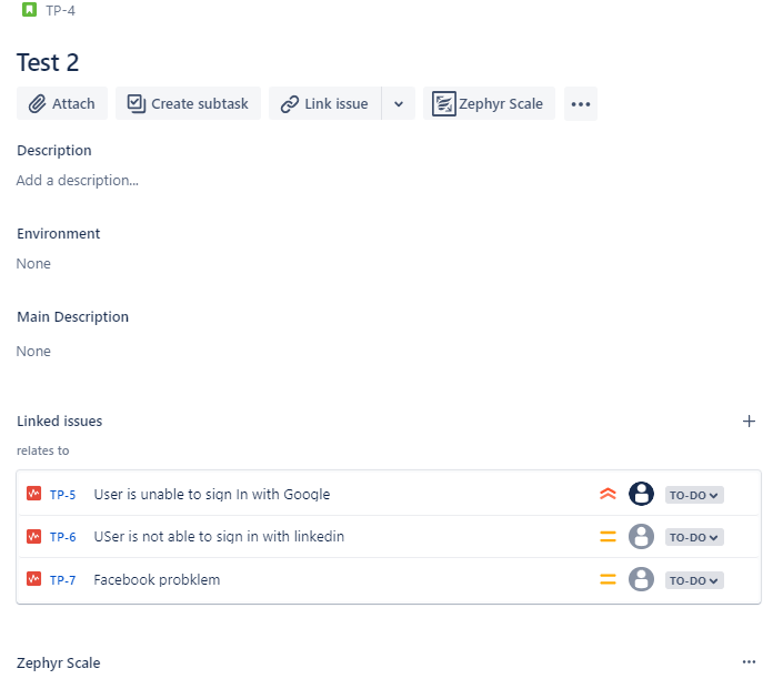

Pic 2:
In Pic 2, all the custom created issues are linked to original user story. This is fine. What I don't want that in Pic 1 the custom issues are shown separately ...If all these bugs are managed the way they are, the board will be crowded and difficult to manage.

I have integrated Zephyr Scale with my Jira and I'm creating these bugs when one of my test cases fail. so whenever my test cases fail, I create a bug against it (custom bug issue type) as Zephyr Scale gives you an option to create an issue when test case fails. I want these bugs at User Story level and not separately.

Update the filter on the board to just pull in the issuetypes you want or vice versa.
Add the below to the filter and the Test case bug issue type won't show on the board.
issuetype != "Test Case Bug"

This looks like a simple and reliable solution to my problem. Thank you so much. Why I didn't think of it.
