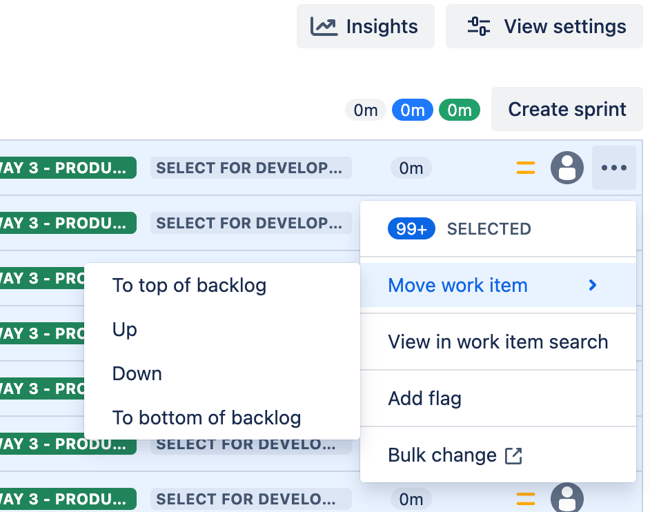

How to Bulk Clone item so I can moved them to a different project.
SianS
July 1, 2025
We have a project in JIRA that serves as a template. How can I bulk clone the items to transfer them to a new project without affecting the original tasks?

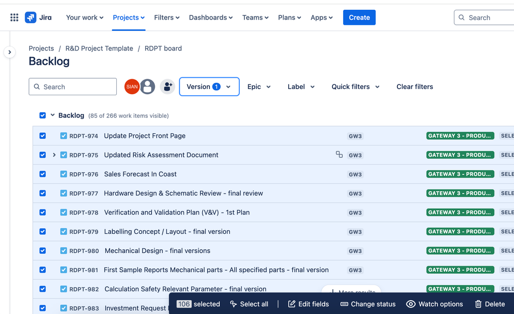

@SianS and there's 106 of these template issues? I ask because in the screenshot you've got that many selected.
