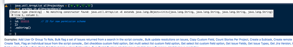

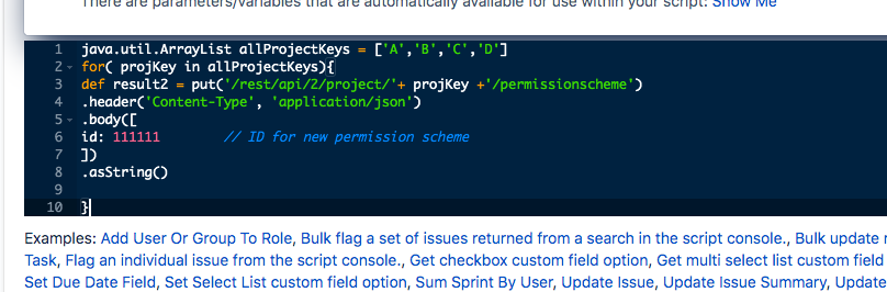

Hi @Bernhard Kirschner  @niranjan  @Zachary Singh I've written script that will help you to change the permission scheme for multiple projects in bulk.
Please find this as -
java.util.ArrayList allProjectKeys = ['A','B','C','D']
for( projKey in allProjectKeys){
def result2 = put('/rest/api/2/project/'+ projKey +'/permissionscheme')
.header('Content-Type', 'application/json')
.body([
id: 111111        // ID for new permission scheme
.asString()
Run the above script in script-runner . Thanks!

Narendra Kumar
November 10, 2020
Hi @Wim Abts  the above script should run. You've to define the ArrayList for your project and just apply the loop and Put call.
First try to run for 4-5 projects to change the permission scheme. Let us know what error you're getting. Thanks!

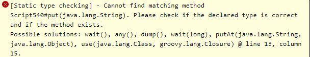

Amar Ghag
April 6, 2021
Hi @Hoc
I have tried that script but its throws me an error "Cannot find matching method".
Using below script in console:
import java.util.ArrayList
import groovy.lang.Closure
import java.lang.String
ArrayList<String> allProjectKeys = new ArrayList<String>();
Arrays.asList('A','B');
.body([
Error :
Hoc
April 6, 2021
Hey,
All I did was copy the original script. The only thing I did was add in the project keys and the project id that were unique to my case.
Is that what u did?
Amar Ghag
April 6, 2021
Hi Hoc,
Yes , earlier I used same code with my project keys and permission scheme ID , same error I got.
After that i have added arrays separately , still same error.
Thanks

Narendra Kumar
June 23, 2021
Hi @Hoc  can you ignore it and run the script? Sometimes, static time error won't stop you to do your work .
If this don't work, just change the Arraylist declaration in Groovy.
Let me know how it works for you. Thanks!
