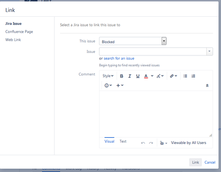

Is there any chance you also show a screenshot of what you are seeing?

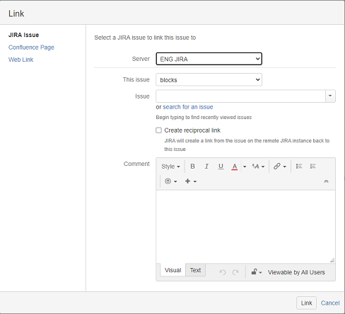

I'm providing below the screen shot of the create link pop-up box.
As can be seen, there is a 'Create reciprocal link' checkbox which I leave unchecked
since I don't want reciprocal link. But when I re-read the descriptive text below the checkbox, I would like to ask if this option (to create reciprocal link or not) available only for 2 different Jira instances ?

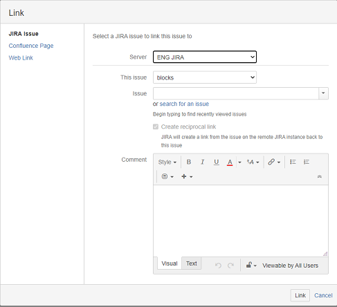

I also observed that if I click on the "Jira Issue" near the left top corner of the pop-up box, then I see below pop-up box where the option "Create reciprocal link" is grayed out and checked by default.

The user interface is quite confusing to me - also because if seems to differ from installation to installation.
As long as only one Server is involved (as per your tests - and as per my tests) only a reciprocal link is possible. So it comes back to what Brant said.
