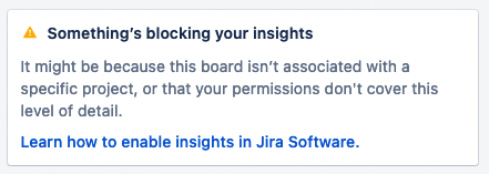

With that change in the filter board Insights stop working in the 5 full stack scrums. A message like this appears:
Despite adding the same filter to the back end scrum board, their Insights are still visible.

So, my question is: is board insights limited to filters including 1 or 2 projects?
I did not find any information in the documentation about that. In fact, the error message suggests that insights should work only if you have 1 project configured, but it has been (and it is working for the back end team) with 2 projects configured, which is even more confusing.
