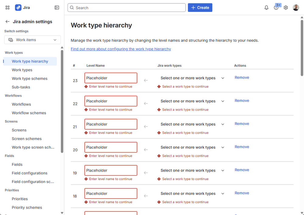

I don't believe a limit has been been published for the number of hierarchy levels, but I recommend that you do your best to keep it simple and not create more than a few levels above Level 1.
When you create a new work item type you can only create them at level 0 and level -1. The Add Work Type screen doesn't allow you to choose levels 1 and higher as those are custom and the dialog is not designed to find out dynamically what levels are available.
First, create your new level in the Work Type Hierarchy screen.
Then from the Work Types screen create your new work item type at level 0.
After creating the new work item type at level 0 you then go to the Work Type Hierarchy screen and click in the Jira work types column for your new level. There you select the new Work Type you created.

I'm wondering how many levels of hierarchy a Jira Premium subscription will support? Currently, we have 4 levels of hierarchy and that seems to be the limit.
Quick info... it's 25 levels in total, including level 0 and -1. So max level is actually 23.
Just to be clear, I've never even seen anything above level 5 or 6 on any instance, and I'd also agree to keep it as simple as possible.
I did test this out during one webinar when someone from the audience asked the same question 😅

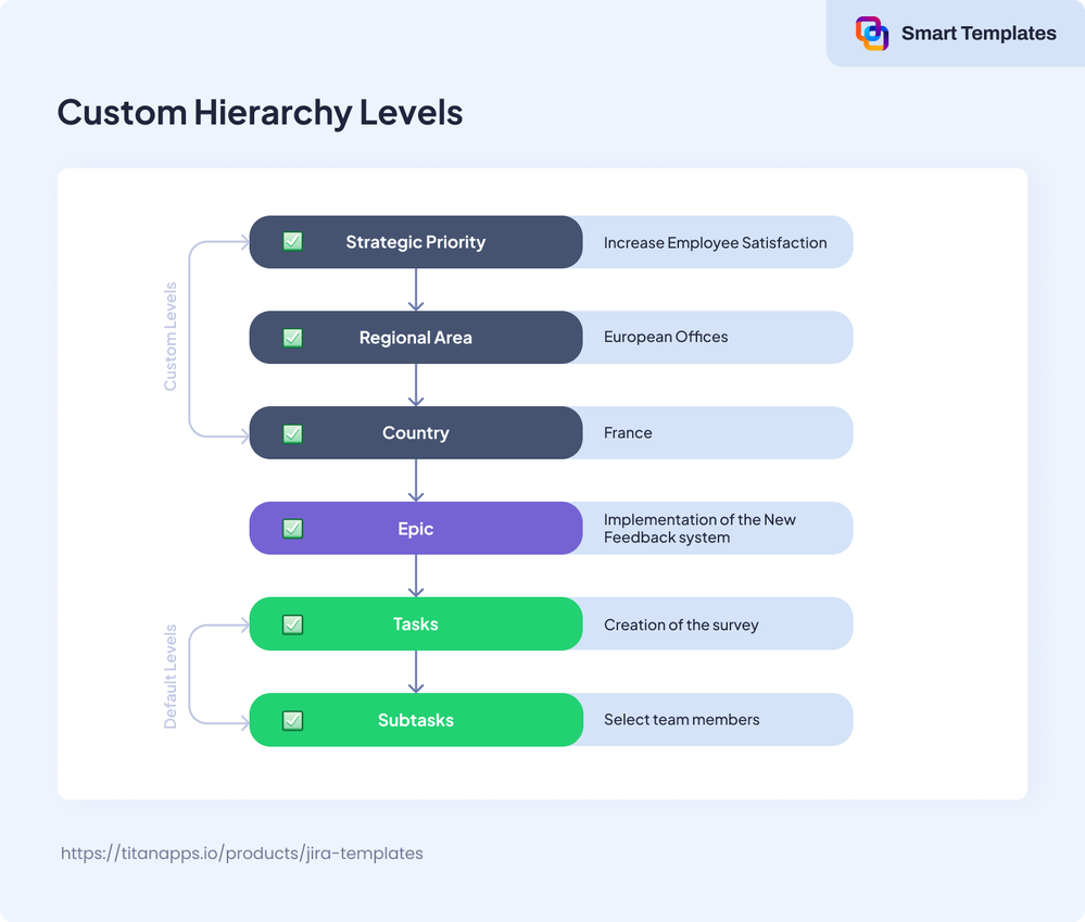

hello  @Clayton !
As the others have already mentioned, you can have pretty much as many levels as you need. You just need to configure them correctly.
I described how to do this with step-by-step instructions in my article Advanced Roadmaps Hierarchy Configuration Guide 2026, so it might be worth a read.
And here's an example of a custom multi-level hierarchy:
I hope this helps! Let me know if you have any questions
