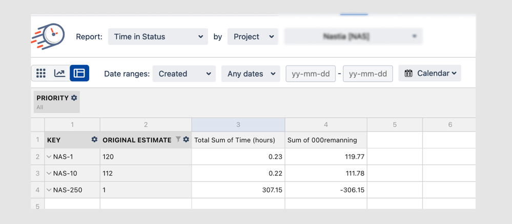

Your request needs some clarification or review, since the Created field it's always DATE (19/May/2021).
At the same time, Original estimate - time amount (2 weeks, 2 days, etc). So, it's hard to calculate exactly what you asked.
However, you might try to use Time in Status for Jira Cloud. It gives you a chance to create the Calculated field within Pivot table functionality.
Add-on itself has a Time in all statuses, and Total time from Created till now in Hours. You can create the Field which will do simple math: Original estimate minus Total spent.
Also, it will reflect your calendar as well. Here is the simple example I've just completed.
Feel free to install it and try with your data or use our Demo instance
Regards,
Anastasiia _SaaSJet_
