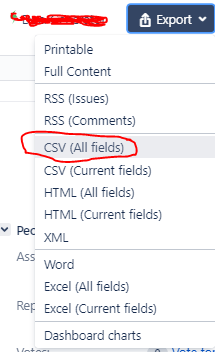

Exporting with option CSV (All fields) will export all fields including issue id, parent id as well as comments. PFB screenshot.

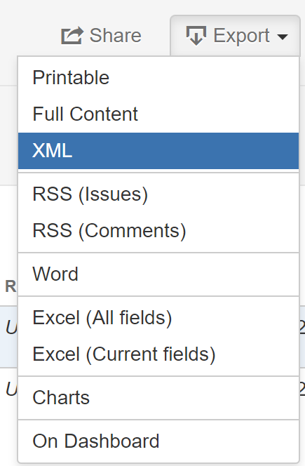

Hi Suvarna, thanks for your response. On the version of Jira I'm exporting from there isn't the option to export as a csv, only to excel then I've saved out as csv. Please see screenshot below of the options. Not sure if this is just due to the version of Jira I'm using.
Suvarna Gaikwad
October 21, 2021
Hi @Julia Taylor Yes it seems the issue is in the JIRA version you are using and this issue has been fixed in 7.2 as mentioned here.
Workaround is to add below property in jira-config.properties in JIRA_HOME and restart your jira instance and then this option will be enabled for your version as well.
jira.csv.export.dialog.enabled = true
If file is not present in JIRA_HOME, create new file and add this property to it.
