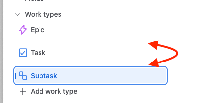

If it is a Team Managed project you would
  1. go to Project Settings for that project.
  2. click on Work Types
  3. Observe up to three layers of issue types separated by gray lines.
This is the area you would go to for a Team Manged project to add an issue type.

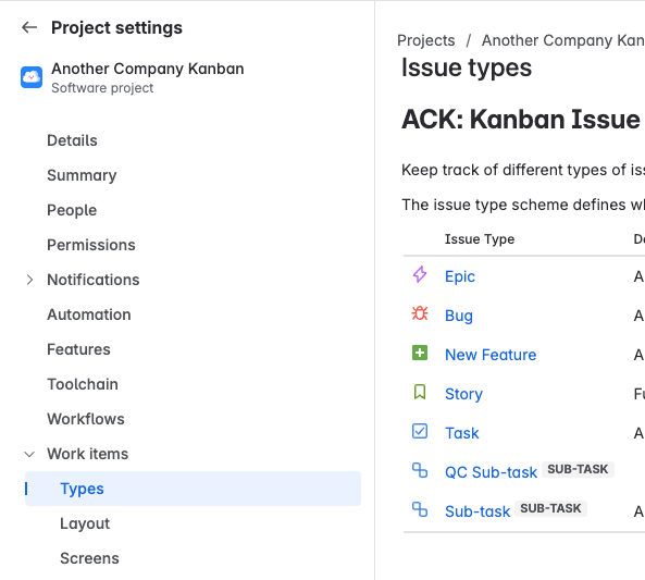

If it is a Company Managed project you would
  1. go to project settings for that project
  2. click on Work Items, then Types, which will display the list of available work items types for the project.
If you don't see a item with the "SUB-TASK" lozenge next to it, then there are no issue types that are subtasks. You can add one to the scheme by clicking the Actions button in the upper right corner and selecting Edit Issue Types.
That takes you to a screen where you can drag available issue types from a list on the right to the grouping for the project's issue type scheme on the left. You then have to click the Save button at the bottom.
However, there may be additional changes needed.
You may not get the workflow you expect associated to the issue type you've added. You may not get the screen you expect associated to the issue type you've added. You may not get the fields you expect associated to the issue type you've added. All those associations are handled by other Schemes.
