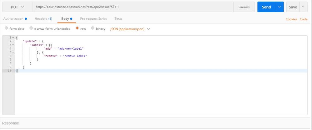

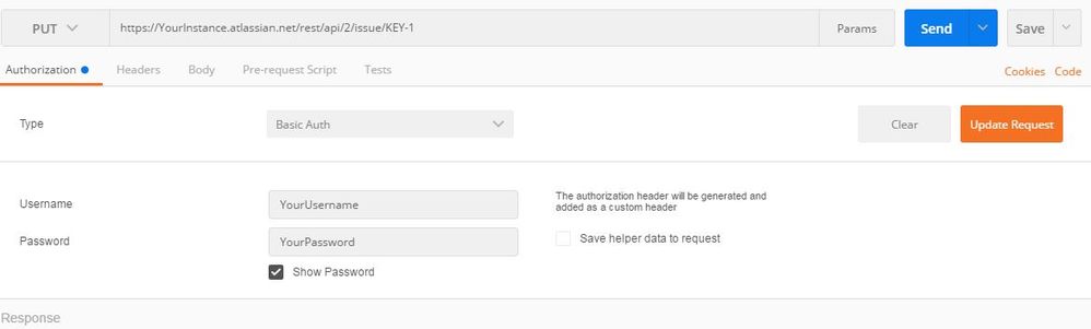

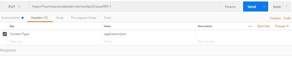

For add/remove label, test with Postman
Method: PUT
URL: https://YourInstance.atlassian.net/rest/api/2/issue/KEY-1
Authorization: Type = Basic. Enter your Username/Password
Headers:
   Key = Content-Type
   Value = application/json
Body: raw
{"update" : {"labels" : [{"add" : "add-new-label"}, {"remove" : "remove-label"}]}}
