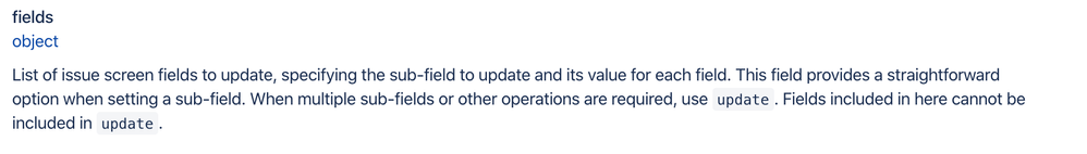

I'm not sure what the best way to do this is, so I think there needs to be more documentation and examples. Maybe I am looking at the wrong places, but the documentation looks a little sparse.
https://developer.atlassian.com/cloud/jira/platform/rest/v3/#api-rest-api-3-issue-post
Screen Shot 2019-11-25 at 11.42.26 AM.pngI would like to know what attributes I can mess around with for "description", but the "fields" attribute is just an object without any explanation of how to utilize the "description" attribute inside of it.
