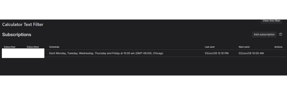

I have a filter i built for a user and when I look at the subscriptions she's the only one subscribed to it, but I've had at least three other people reach out that they're receiving a weekly email subscription to this filter (I am as well) and I can't figure out how that's happening. It has been happening every Monday morning since May 4th.

Hi @Nicholas Woltring
Are you certain they are getting subscription emails for the same, named filter?  The one you show includes a schedule with every weekday for you and likely the one intended recipient.
Next, if you view the filter and check the subscriptions from there, are the other people / users noted so they can be removed?

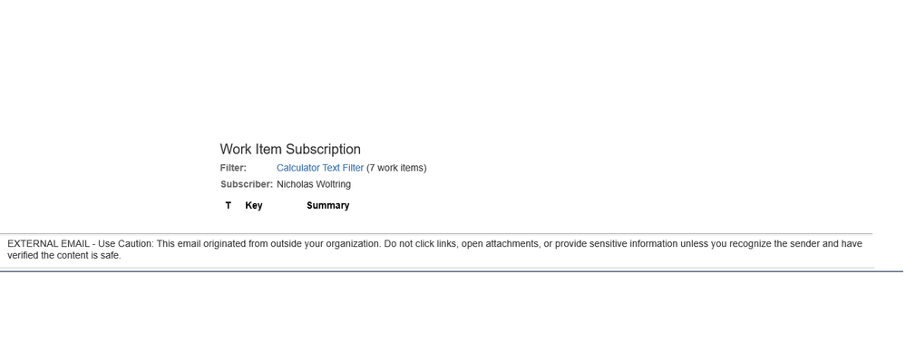

Nicholas Woltring
June 1, 2026
Yes, it's the same filter (I'm one of the recipients) the one subscription is for a single named user and there are no other subscriptions on the filter and no other users and as you can see there is no unsubscribe option in the email.

Did you try from the email link "You may edit this subscription here" for one of those people?
Nicholas Woltring
June 1, 2026
That link isn't there- that's the second part of the screenshot I attached, it should be right under the external email warning and is in any other filter I'm subscribed to but absolutely isn't there for any of the users that are getting this subscription now. I couldn't find anyone else having this same issue and didn't know it was one until some people messaged me today on it but apparently it's been going for a month now.
