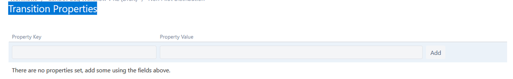

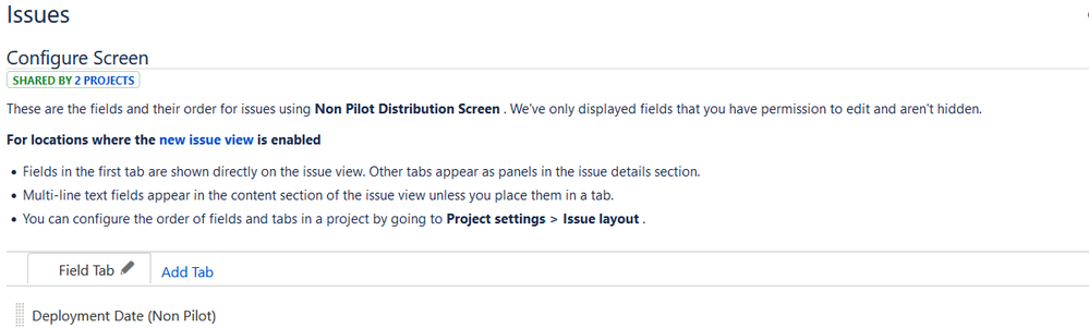

@Bill Sheboy  So the issue im finding is that the field for (Package name) is being used in a transition screen placed in the workflow our in the project we use for our jira tickets.
From reading the documentation for jira I am unable to edit those field, only add, remove or change the placement but I also see in the workflow where i can edit the options for that screen. Would that be where i need to make the change to see if i remove the field editor markup?

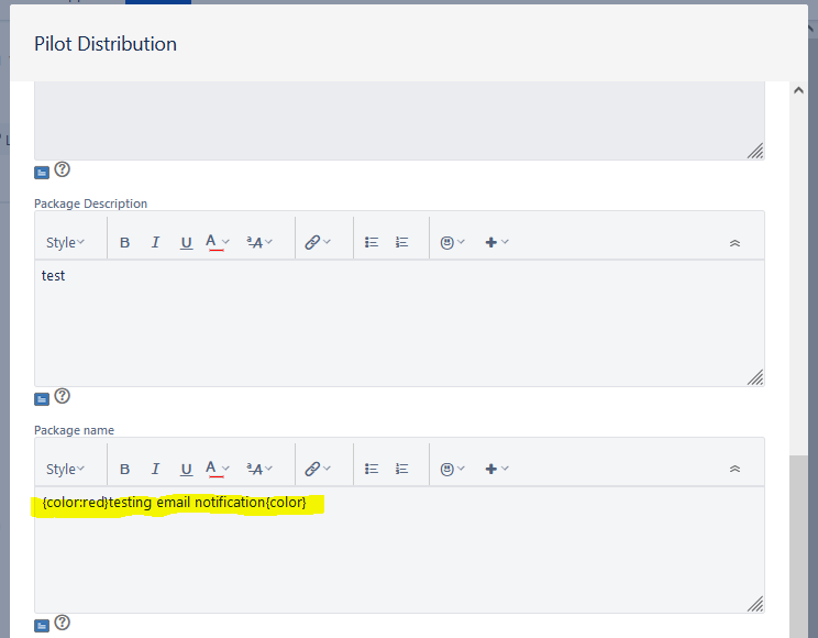

@Bill SheboyYes that is what im doing, sorry for the confusion. I was only adding examples since im still new to Jira and im not sure where to correct this issue at.
I have added a screenshot as well of what the field looks like and how we are filling it out as well as highlighted the issue.
Due to people copy and pasting in the Package name i thought it should be able to handle any color and font but it does not convert the color in the package name field during the transition screen.
Only in the jira ticket itself as the example from my first post shows does it show the color change to red for testing email notification underneath the Package name field.
So when using an Automation for Jira rule to send an email it keeps the same format as plain text with the {color:red} added beside it instead of changing the plain text to red.
