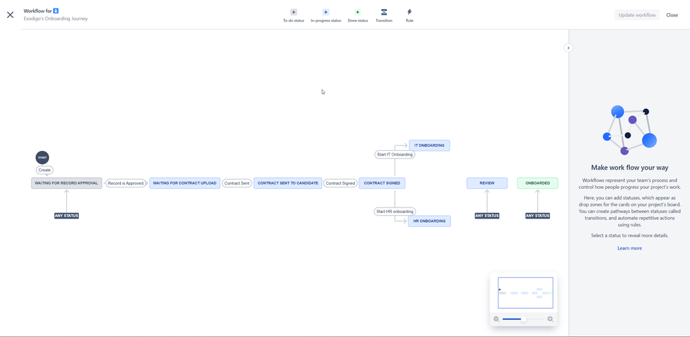

when i click the edit workflow button i just get to here:
r/jira - How do i find a transition ID?

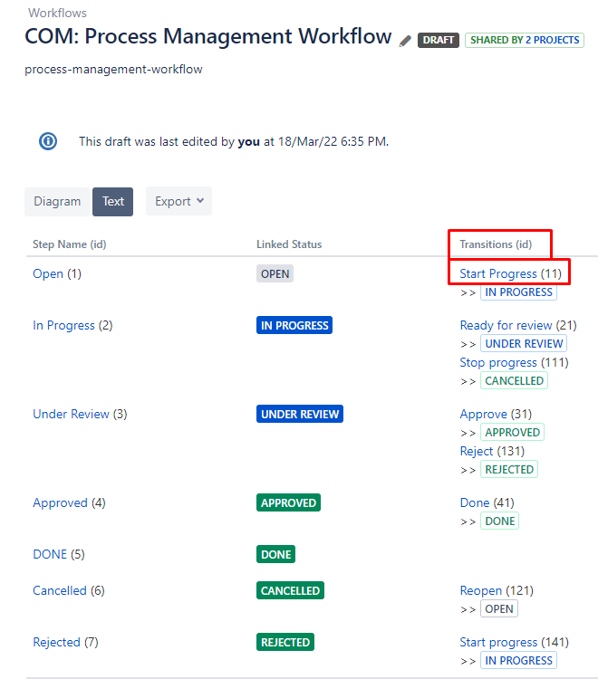

Hi Asaf,
Welcome, if you go to the workflow where the transition is  located, and you see it in text form, you will find the Transitions and their ID's:
Let us know how it goes.

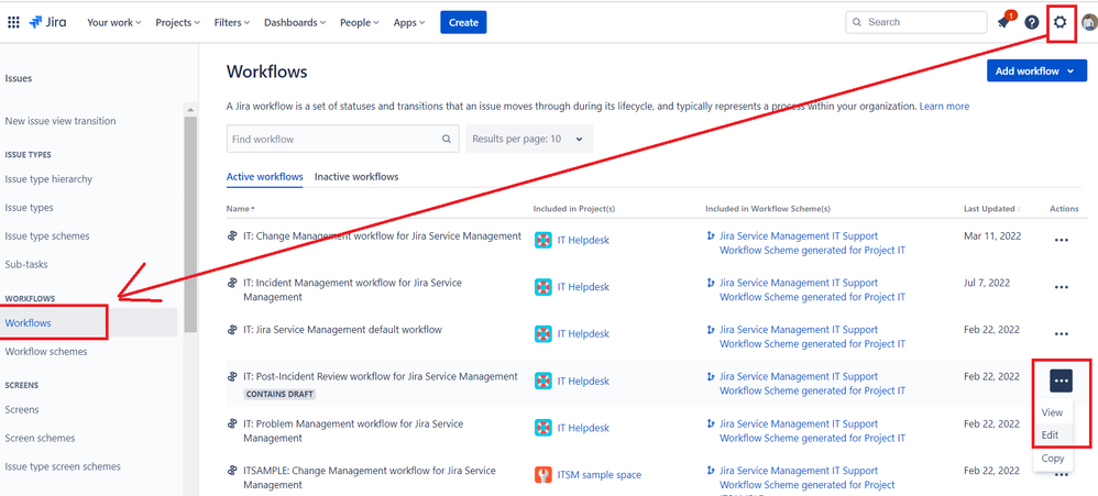

Hi @Asaf Zade ,
Welcome to the community !!
To find a transition ID, you need to open the workflow from Admin settings --> Issues --> Workflow.
Click on Edit against the required workflow and open in text mode.
Now click on the transition and in the url you can find the ID.
   It will have like "workflowTransition=9252"
Asaf Zade
August 22, 2022
Thank you, i have made a scheme but i do not see the project i need in the project list when trying to associate it with my project
I only see company-managed projects in the list while the one im working on is team-managed
what do i do?

Look above the diagram, the tabs are Diagram / Text / Export.
You'll find each transition name has a number next to it in ()
Asaf Zade
August 22, 2022
am i missing something?
Nic Brough -Adaptavist-
August 22, 2022
Ah, no, you're not missing anything.  Team-managed projects contain the workflow, and the editor for them doesn't have a text mode.  (Another reason I tell people not to use team-managed projects - they're not yet ready for any serious usage)
You'll need to use @Mohamed Benziane suggestion of grabbing them from the REST API.
