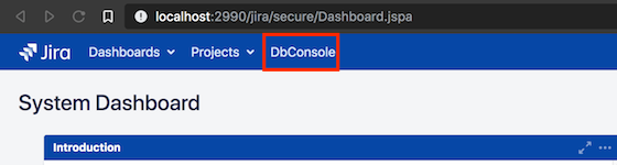

With the SDK, I think the steps to access that H2 database would be similar, but I wasn't sure of the exact path to try.   So I installed the Atlassian SDK myself and started following the plugin tutorial.  To my surprise, I found that with Jira running, after I logged in with admin/admin credentials, the top navigation bar has a DbConsole link.
This is not something you see in standard Jira, but appears at least to be a nice feature of the SDK itself.
When I click that, I get taken to a URL of http://localhost:2990/jira/plugins/servlet/database-console/login.do
This is a built in view of the Jira database, complete with the AO tables.  Perhaps this would help you access that data without having to follow that first KB, which is geared for different, non-SDK installs of Jira.
I used the 8.0.7 version of the Atlassian SDK.  So perhaps older versions might not have this feature.
Perhaps this would help you access that data.  And if for some reason you still want to try to follow the first KB, you can still find the specific database location for that instance by clicking on that dbconsole link and looking at the top level.  In my instance on a Mac this path this
jdbc:h2:file:/Users/myusername/andytest/myPlugin/target/jira/home/database/h2db
This is the same path you would need to use to access this database via any other database tool.
