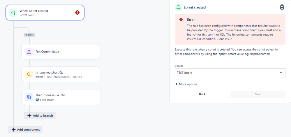

The screenshot below is as far as I've gotten:
I don't understand how to address the error, let alone get any farther. As far as I can tell, there is no way to indicate the "[required] issues to be provided by the trigger." There's a branch. There's a JQL query that points to the Epic to be cloned. What am I missing?

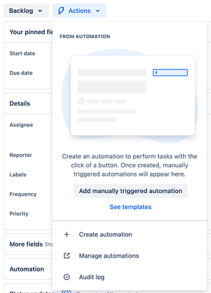

The rule - as it is - is designed to be triggered manually from the epic you want to clone. If you set up the rule and then open an epic, you will be able to see and fire the automation from here, under Actions:
Maybe that is sufficient to get started, but it does not get fired automatically when a sprint is started. And that is where things may get tricky ...

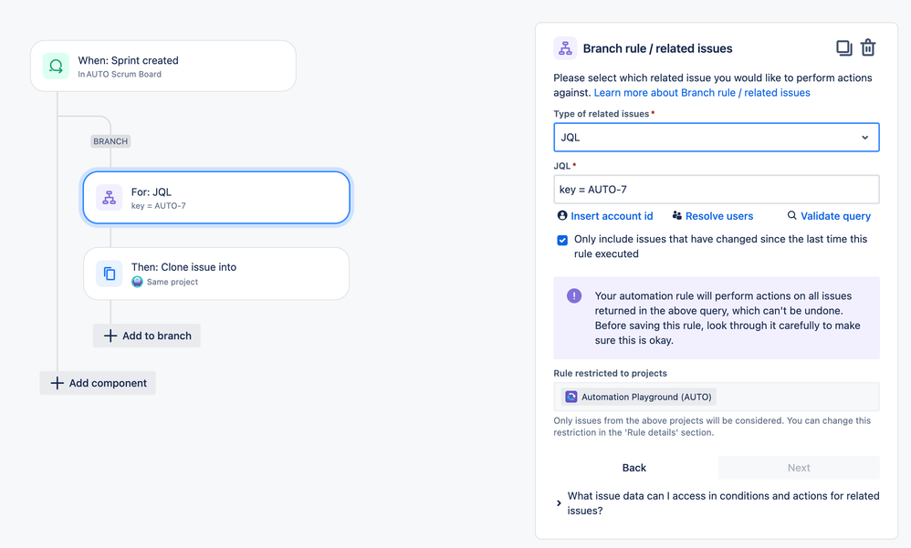

The branch in your screenshot won't work. It needs to be a For JQL trigger in order to perform the clone issue action on your epic, like this:
As you will see from the template rule, you then need an additional branch to also clone the linked issues. And that is not possible, as you cannot add a branch to another branch.

The Error message is explained like so:
Your trigger will give you some sort of return value. Your trigger "when sprint is created" will give you a reference on the Sprint, that has just been created.
Branching works a bit like For-each-loops (for every item i give you, do xyz). In your branch you are referencing a "current issue". But there is no "current issue", as your trigger only give you a sprint.
To achieve your logic, you would need to look up the Epic, clone the epic, then branch on all children and change their parent.
However, you will have issues running that rule automatically, as Jira would have to know what Epic you want to clone. As there is probably no foreseeable pattern in the id/name, that is gonna be difficult.
It would probably be easier, to trigger the rule manually on the Epic itself. Then your trigger will give you the epic and you can go from there. If you give me a bit, I can probably put together the rule for you.
