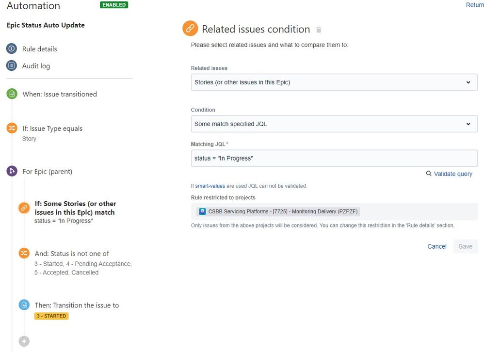

I am trying to change an Epic status to "Started" when any story that it's linked to changes to "In Progress". I can get this to work when the Epic and related stories are within the same project, but it does not work when the Epic is in another project. I have added a screenshot of the rule that works with the Epic and Story in the same project, but does not work for my current situation.

When a rule runs it adds to its Audit Log. When you try this rule with an Epic and child issue in different projects, what are you getting in the audit log? If there is no entry, then the rule is not being triggered at all and you need to look at the trigger information to figure out why.
If the rule is getting triggered but not yielding the expected results, then the audit log should contain some information that helps diagnose the problem.
So, please try to transition an issue where the parent is in a different project, and show us/review the output generated in the Audit Log for the rule.
In case you didn't notice, the Audit Log link is on the left above the flow diagram for the rule.
Steven Johnson
August 2, 2022
There is no triggering happening at all. Just the config changes and "no actions performed". So I think I may understand the difference in working between my projects and why the one did work. The issue and rule were in the same project that created an issue in another project, so that issue never ran a rule in the other project. This one is a rule in the one project that I need triggered by an issue change in another project, so the "no actions performed" in the audit log specifies "This rule was configured with a project restriction. You can change this restriction in the 'Rule details' section. Only issues from the following projects or project types will be considered: PZPZF" So it's not being triggered.

The limitation you are facing happens because your automation rule is restricted to a single project - Where the trigger issue is transitioned.
In order to change the scope of the rule to include more projects, you can follow the steps below:
  1. Navigate to the same automation screen you took the screenshot from
  2. Click on Rule details
  3. Click to change the scope of the rule, selecting the projects you want
  4. Click to save your changes
P.S: Depending on the menu you are in, you may see the following warning for the scope field on the Rule details page:
"The scope can only be modified in the global administration."
In that case, click on the link "Global Administration" to properly change the scope of your rule and include more projects.
