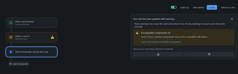

I am trying to set-up different types of automation rules to help clear the clutter off our board. What I want to do is when we start a sprint, if an issue has a REMOVED status, to delete the issue.
I get a Incompatible components warning in the IF (status) when I set it up as such:
When: Sprint started
Status if one of
REMOVED
Then: Permanently remove this issue
What are the issues preventing me from running something like this (and is there an alternative to cleaning up our board automatically)?

Hi @Eliot Hong and welcome to the Community!
While I cannot imagine why you would want to set up a process like this (having a status to mark issues for permanent deletion, deleting issues altogether, in your current setup even Done issues, ...), but that would be an extensive, different discussion ...
After your sprint started trigger, you need to add a branch first on related issues > issues in sprint.
Right now, you are trying to check the status of the issues in your sprint, but your automation rule is looking at the sprint you just created rather than the issues in it. Then move the status condition and the subsequent actions into that branch.
Just be careful when you start thinking about deleting stuff from Jira. When an issue is gone, it's gone forever and you won't be able to recover it.
Hope this helps!
