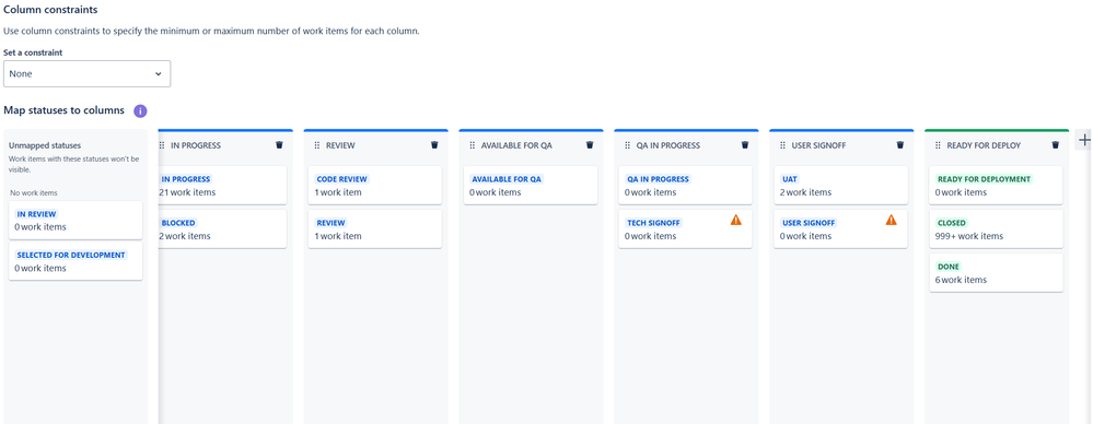

3. My active sprint board looks like this:

Hi @dew
The burndown chart will only think that issues in Ready for Release are completed if this status is mapped to the final (green) column of your board.
So you will need to map this status to the column next to it (and then you can remove this empty column)

I have this same issue except I do have all green / "Done" statusCategory types in the right most column and yet still my Sprint Report doesn't count them as completed. What am I missing? This is pretty frustrating... Thanks in advance.
