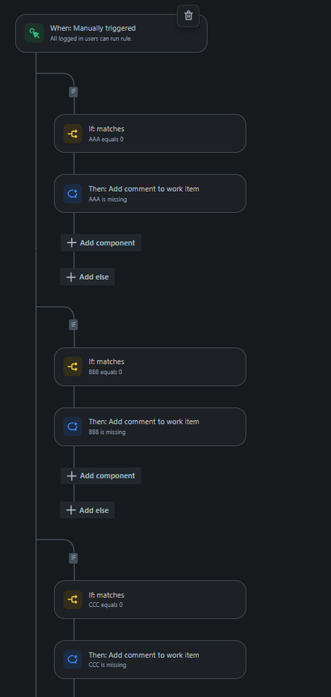

I am trying to build a rule where a issue description is checked for multiple missing parts and for each missing part, a IF condition should be executed to trigger a specific comment to be added regarding that missing part.
For example:
Issue Description 1:
AAA
BBB
CCC
- Example text
In this case, I want to have 2 comments execute saying that "AAA is empty" and "BBB is empty".
Issue Description 2:
AAA
BBB
- Example text
CCC
- Example text
In this case, I want to have 1 comment execute saying that "AAA is empty".
I have been trying to use multiple IF statements but it seems that only the first block will execute and the subsequent blocks do not execute. So it ends up that only "AAA" is checked for missing values but if that condition passes, the remaining conditions are not checked for missing values.
Does anyone have a solution to this problem that allows me to run IF blocks in parallel on the same issue description?

Trudy P Claspill
July 10, 2025
Hello @dominiclau.intern
An alternative to @Stephen_Lugton 's suggestion is to simply set up a separate rule for each check that you want to do.  As the number of items you want to check increases, your combinations for if-else-if statements will grow exponentially.

Bill Sheboy
July 10, 2025
Hi @dominiclau.intern -- Welcome to the Atlassian Community!
First thing: what problem are you trying to solve by doing this?  That is, "why do this?"
Knowing that will help the community offer better suggestions.
Next, your question describes parsing / checking text in the Description field for missing content, but the rule image shown is apparently checking custom fields named AAA, BBB, and CCC.
Which of these cases do you want to check: the Description or the Custom Fields?
And, if it is the Description field, is the format of your text consistent and stable enough to perform such checks?

Bill Sheboy
July 11, 2025
Thank you for clarifying the format, and...
Please note this may a brittle solution as a person could easily "break" the template when entering the Description field.  Providing them specific custom fields to enter may be better.
Regardless of that challenge, please try using text functions:
You could use either substringBetween() to find any included plain text, or match() with a regular expression.  Then, trim() the result to remove any blank spacing and test the result for emptiness.
For example:
{{issue.description.substringBetween("*Issue details (*In depth explanation of the issues faced)", "*Issue Occurrence (*How does the issue occur)").trim()}}

Stephen_Lugton
July 10, 2025
Rather than using 3 separate If matches, just use 1 and then add elseif checks e.g.
If: matches
AAA equals 0
BBB equals 0
CCC equals 0
comment: "AAA is empty"
comment: "BBB is empty"
comment: "CCC is empty"
Else-If; matches
AAA equals 0
BBB equals 0
CCC does not equal 0
Else-If; matches
AAA equals 0
BBB does not equal 0
CCC equals 0
Else-If; matches
AAA equals 0
Else-If; matches
AAA does not equal 0
BBB equals 0
CCC equals 0
Else-If; matches
BBB equals 0
Else-If; matches
BBB does not equal0
CCC equals 0
