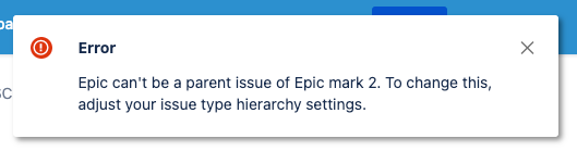

When I try to drag an Epic mark 2 type of issue into an Epic on a Backlog screen (for a Company Managed project), I get an error message and am not able to complete the task.

Actually, I am not able to add such an issue as a child of an Epic. If I select 'Add a Child Issue' when in an Epic I see the new Issue type in the dropdown list - suggesting I can add it as a child - the create screen appears but when I submit it nothing happens - it just hangs.
I am using company-managed projects.
This seems a little buggy to me - surely if you can't add it as a child then it should not appear in the list.
For other issue types, I can add validators as you suggest but that means someone has to complete the whole create screen before they are told they can't do it. Would seem to make more sense if you could just define the allowed hierarchy.
