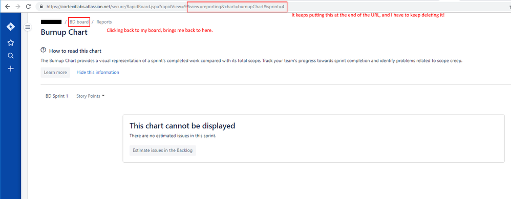

I am not sure how I did this in Jira, but whenever I click on a board with URL eg ".../RapidBoard.jspa?rapidView=9", it will automatically add "&useStoredSettings=true" to the end of the URL.
Then immediately, the URL gets updated with ".../RapidBoard.jspa?rapidView=9&view=reporting&chart=burnupChart&sprint=4".

The only problem I have with this setting is that whenever I try to open a board, it adds "&useStoredSettings=true" which changes to "&view=reporting&chart=burnupChart&sprint=4". This gives me  the "Burnup Chart" with message "This chart cannot be displayed. There are no estimated issues in this sprint". So I see nothing - no stories nor issues.
So I click on the board name in the breadcrumb (top left corner), but it does the same thing again. That is add "&useStoredSettings=true" which changes to "&view=reporting&chart=burnupChart&sprint=4", which gives me the "Burnup Chart" with the same error.
So I can never get back to that board using the webpage, unless I explicity modify the URL to remove anything extra eg "&view=reporting&chart=burnupChart&sprint=4".

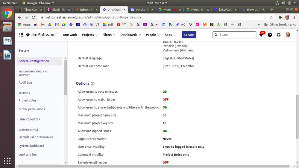

NIROSHAN MADAMPITIGE
January 24, 2021
I had the same issue for a few days - after a heavy research found that this is due to the URL change with "&useStoredSettings=true ". Her is what solved this.
Go to Settings > System
When I had the problem of loading the boards, "Allow users to watch issues" was set to "ON". Look like it's a bug associate with that. Changing this to "OFF" resolves the captioned issue.
