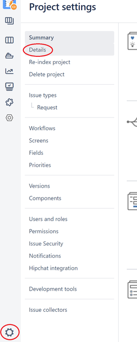

Try using its ID rather than its name (e.g. project = 10800). One way to find that value: go into the project's settings (cog icon in the lower left) and then hover over the Details link in the left sidebar.

Thanks, using the id works which gets round my immediate problem so I have accepted this answer. I'm sure there must be a way to escape the ampersand but this is an acceptable workaround, thanks. As I guess would be writing a saved filter and using 'filter = 123' which I had considered but did not want to do for ease of maintenance reasons.
