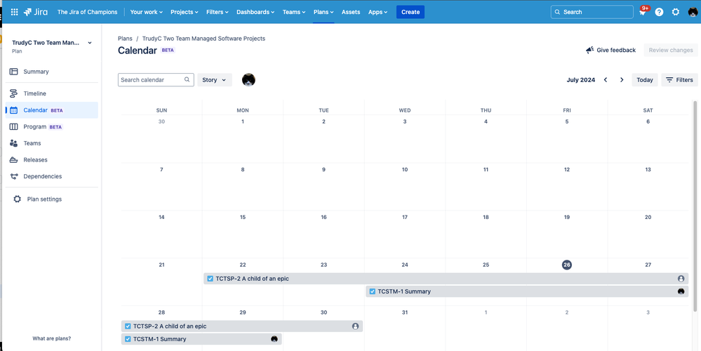

For multiple Team Managed projects you would need to create and save a filter that retrieves the issues from all the projects of interest.
If you created an Agile board from that filter you would not be able to get the Calendar view associated with that board. That specific Calendar view is available only when the board pulls issues explicitly from only one project.
But you could get a Calendar view by creating a Plan based on that filter. Plans are the advanced roadmap planning tool available in Premium and Enterprise subscriptions. They can be based on any combination of projects, boards, and filters. There is a Calendar option in the Plans. It is currently marked (in my system) as Beta, so it may or may not be available in your system.

@Trudy P Claspill I think I set up the Plan correctly but quick question does it update in real time? So if I were to create a new ticket in one of the boards after having created the plan would the new ticket autmatically be reflected in the plan?
Trudy P Claspill
July 29, 2024
Hello @Darby Kim
You may have to refresh the display if you already have the Plan displayed.
And then it depends on what you have defined as sources for your Plan. If the new issue falls within the scope of the defined Sources, then it should appear in the Plan upon a refresh.
