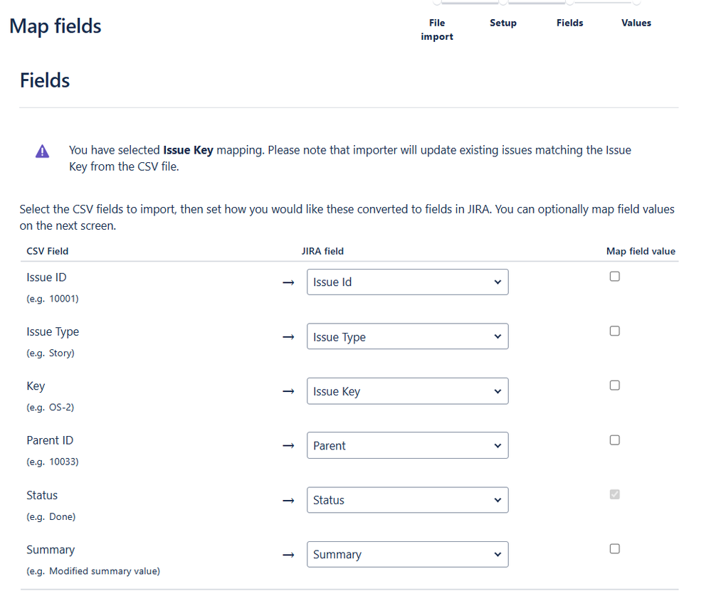

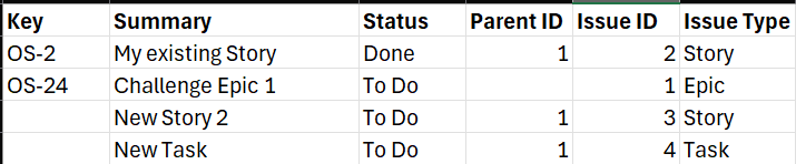

Refer to the mapping in the provided screenshot. In the example, the first two rows correspond to issues that already exist in Jira. The existing Epic has been assigned a placeholder ID of 1. Stories and tasks in rows 3 and 4 are linked to this Epic by setting their Parent ID to 1.
You can now proceed with importing issues via CSV by mapping all the necessary fields. This will allow you to import new issues linked to the specified Epic. For more details, please refer to this guide.

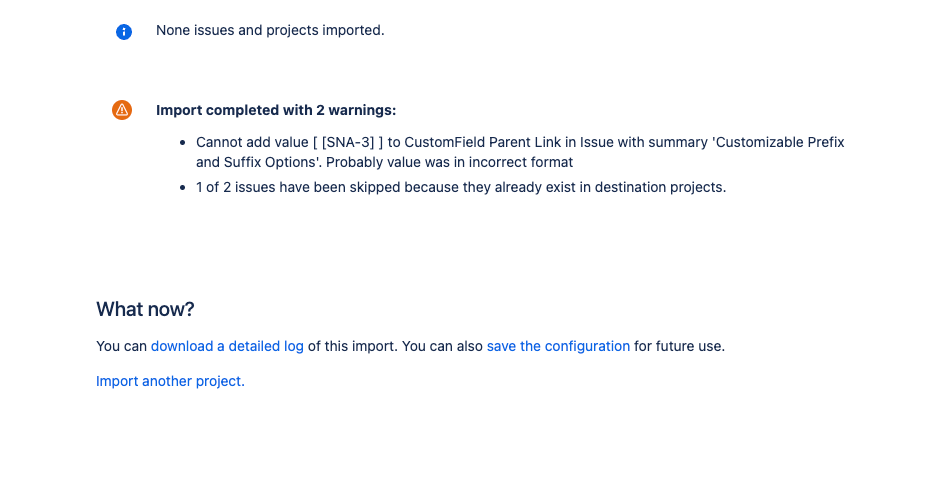

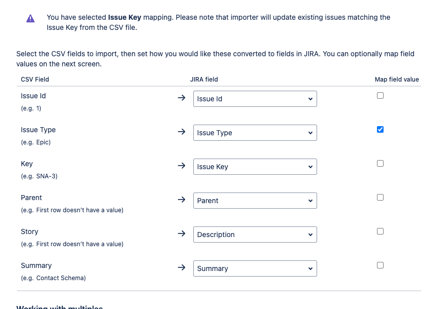

Seems like I did the right thing here but I keep getting this:
Screenshot 2025-01-17 at 10.37.14 AM.pngScreenshot 2025-01-17 at 10.37.56 AM.pngScreenshot 2025-01-17 at 10.38.50 AM.png

Akash, I appreciate your responses.  Did you see the spreadsheet I provided in the images above?  Does anything in that image suggest that they are in the same hierarchy?
Akash Singh
January 17, 2025
@Chris GorgorosoThe issue hierarchy in the spreadsheet appears to be correct. However, exporting the issues directly from Jira could have eliminated the possibility of any misconfiguration. If you downloaded the detailed log of the import, could you please share it as well?

2025-01-17 19:08:23,279 INFO - Import started by 3dd7e447-cbee-45a8-9540-1251eb517b53 using com.atlassian.jira.plugins.importer.imports.csv.CsvDataBean
2025-01-17 19:08:23,369 INFO - ------------------------------
2025-01-17 19:08:23,369 INFO - Importing: Users
2025-01-17 19:08:23,369 INFO - Only new items will be imported
2025-01-17 19:08:23,373 INFO - 0 users associated with import. All of them imported as inactive, this can be changed after import in User Access step.
2025-01-17 19:08:23,373 INFO - ------------------------------
2025-01-17 19:08:23,373 INFO - Finished Importing : Users
2025-01-17 19:08:23,373 INFO - 0 users successfully created.
2025-01-17 19:08:23,376 INFO - Retrieving projects...
2025-01-17 19:08:23,393 INFO - Project ExternalProject{id='null', key='SNA', externalName='null', name='SNA', type='software', template='null'} exists and found correctly.
2025-01-17 19:08:23,394 INFO - ------------------------------
2025-01-17 19:08:23,394 INFO - Importing: Versions
2025-01-17 19:08:23,394 INFO - Only new items will be imported
2025-01-17 19:08:23,394 INFO - Finished Importing : Versions
2025-01-17 19:08:23,396 INFO - ------------------------------
2025-01-17 19:08:23,396 INFO - Importing: Components
2025-01-17 19:08:23,396 INFO - Only new items will be imported
2025-01-17 19:08:23,396 INFO - Finished Importing : Components
2025-01-17 19:08:23,403 INFO - Retrieving custom fields...
2025-01-17 19:08:23,409 INFO - ------------------------------
2025-01-17 19:08:23,409 INFO - Importing: Issues
2025-01-17 19:08:23,409 INFO - Only new items will be imported
2025-01-17 19:08:23,592 INFO - Importing issue: [externalId='1', summary='Contact Schema']
2025-01-17 19:08:24,101 WARN - Cannot add value [ [SNA-90] ] to CustomField Parent Link in Issue with summary 'Customizable Prefix and Suffix Options'. Probably value was in incorrect format
2025-01-17 19:08:24,106 INFO - Importing issue: [externalId='2', summary='Customizable Prefix and Suffix Options']
2025-01-17 19:08:24,432 INFO - 2 issues successfully created
2025-01-17 19:08:24,432 INFO - 0 out of 2 issues successfully updated
2025-01-17 19:08:24,436 INFO - ------------------------------
2025-01-17 19:08:24,436 INFO - Finished Importing : Issues
2025-01-17 19:08:24,452 INFO - ------------------------------
2025-01-17 19:08:24,452 INFO - Importing: Issue Links & Subtasks
2025-01-17 19:08:24,452 INFO - Only new items will be imported
2025-01-17 19:08:24,456 INFO - ------------------------------
2025-01-17 19:08:24,456 INFO - Finished Importing : Issue Links & Subtasks
2025-01-17 19:08:24,457 INFO - ------------------------------
2025-01-17 19:08:24,457 INFO - Importing: Issue remote links
2025-01-17 19:08:24,457 INFO - Only new items will be imported
2025-01-17 19:08:24,460 INFO - ------------------------------
2025-01-17 19:08:24,460 INFO - Finished Importing : Issue remote links
