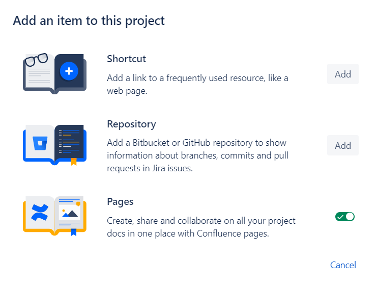

Dave Liao
October 4, 2020
@joe holdsworth - sorry to hear about your troubles!
When you click "Add item", you should see a prompt to add either a shortcut, repository, or pages. Then after selecting repository, you'll see "Integrate Bitbucket" as the final button.
Dave Liao
October 4, 2020
If you don't get prompted for an item type, I'd go into your project's settings, then click "Development tools", then connect Bitbucket Cloud that way.
Good luck!

joe holdsworth
October 4, 2020
Thanks Dave, for add item in the jira project I only get add shortcut and a prompt to put in a url, repository and pages are not options, the menu doesn't look like that either after clicking add item

Dave Liao
October 5, 2020
No problem! I'm trying to figure out how to always get that prompt:
  • In my Service Desk projects, I can only add Shortcuts.
  • In my Software projects, I get prompted to choose between Shortcuts, Repositories, etc., then after adding a Repo, I only see the Shortcut prompt.
One of these days I'll figure it out... ¯\_(ツ)_/¯

Dave Liao
October 6, 2020
Nope, just go into your project settings like I mentioned in my earlier comment. ☺
