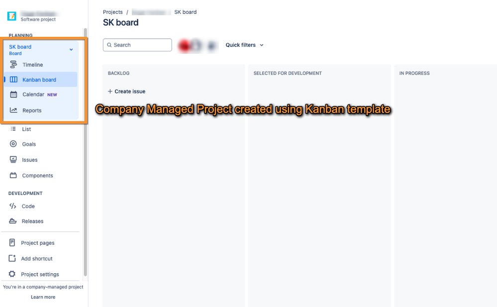

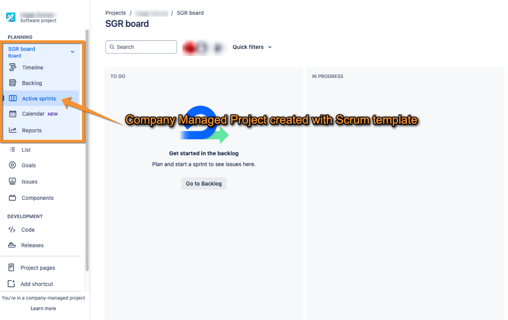

1. The basic difference is scrum projects have a Active sprints in the board sidebar and Kanban projects not. please check the attached screenshots.
2. You can verify this by click on the boards if the boards belong to that projects have active sprints then it is scrum project and it not then it is Kanban project. here you can view the boards from other projects as well, so check only the board belong to the current project to confirm.

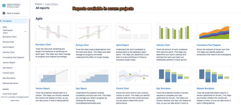

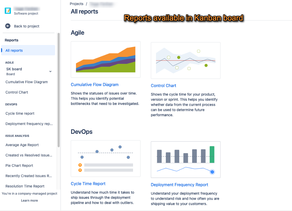

3. Scrum projects and Kanban projects have different reports available so you can check that as well if board is scrum or Kanban, scrum projects have more reports available compare to Kanban board some of them are as shown in the attached screenshot.

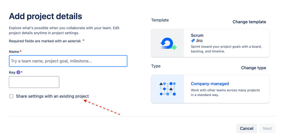

Tip: During the project creation wizard you will be allowed to choose to use the same config as an existing project. First you choose software project, then you choose the template, then you choose if it's Team vs Company managed, then this screen appears.
If choosing to share, then the config will not be taken from the template, it will be the same as for the existing project.
