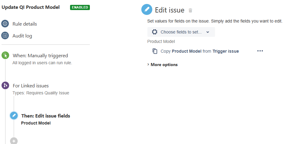

Using JSM Automation, the following works as expected
But when I try to do a scheduled trigger using JQL to filter for issues using and issueFunction in hasLinks("Requires Quality Issue") in order to update the linked issue with Copy Product Model from Current Issue, my audit log indicates "Success" but the linked issue is not updated and I see No related issues could be found.  I have over 200 issues with linked issues that need to be updated so I am hoping I do not have to do each one manually.

If my issue is A123 and my linked issue is B123 and I run the automation manually from A123, the rule runs as expected and B123 is updated.  If I run the automation as scheduled trigger and filter for key=A123 then the rule doesn't work.  I am wondering if I am using the correct Copy from process in the scheduled trigger flow.

But I did find my fix.  I changed the "Copy From" to use Trigger Issue versus Current Issue.  My assumption was that Trigger Issue was for a Manual Trigger and that Current Issue was used when iterating through the results of the JQL query.
