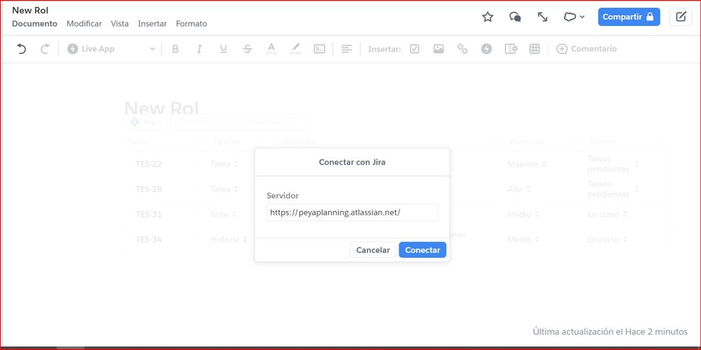

Trying to connect Quip to a Jira Cloud instance - I'm running into the same issue. After I put in my Jira Cloud URL and click "Connect", I see a pop-up and then it disappears. (That's where you're supposed to log in with your Atlassian ID.)
I tried to make this connection in the latest non-beta versions of Microsoft Edge and Google Chrome for Windows. Also tried in an incognito window, but no luck.
