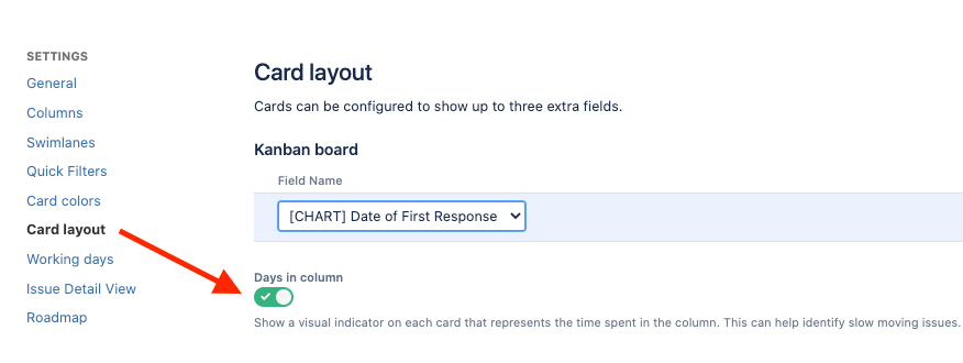

Are you referring to the "Days in column" feature? That is available from Board Settings > Card Layout, for boards set up for Company Managed projects.

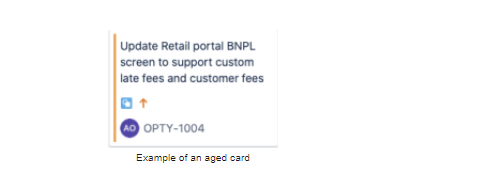

Hi @TrudyClaspill , thank you so much for your response. I am new to using Jira so just to clarify,  is that the same as the picture below, where it is shown with a color , to help represent cards  on the  board that hasn't progressed in a while. If yes then do I need to add any specific add on  or enable any feature on the boardcard.PNG

What I highlighted is not the same as adding colors to cards. For Company Managed projects that would be the Card Colors feature, which is listed directly above the Card Layout item in the image I posted.
To add colors to cards you have to have a filter that specifies the condition to be met for the color to be applied. What is your definition for "hasn't progressed in a while"? Does that mean that the status has not changed? Or does that mean there have been no updates of any kind (i.e no comments added, no fields updated)?

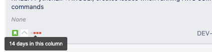

What I highlighted results in dot appearing on the cards to give you an indication of how long the card has been in the specified column. You can hover over the dots to see exactly how long that is.
The number of dots colored in and the color used is generated automatically by JIRA, and is not configurable.

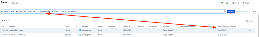

"Status Category Changed" is not a field you can display in the Issue View. It is a field that can be used when you are building search filters, and you can display the output for the field in the List View of search results.
