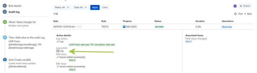

Thank you @Bill Sheboy for your attention to my problem.

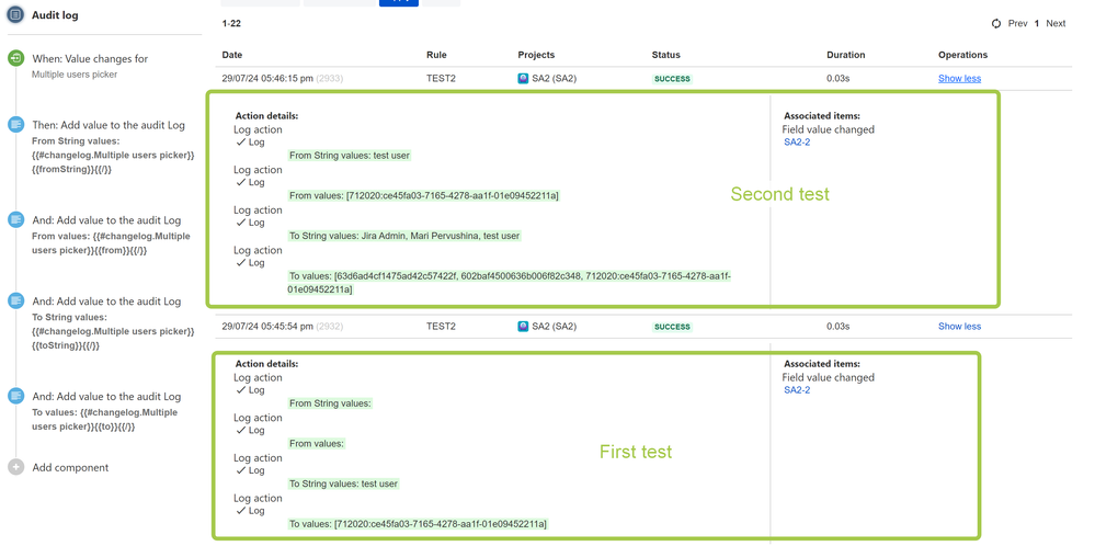

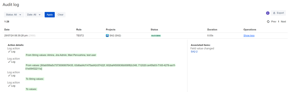

I did two tests. In the first one, I had an empty field and added one value "test user". In the second test, I added two values ​​Mari and Jira Admin to the same field. And this is what is in the logs.

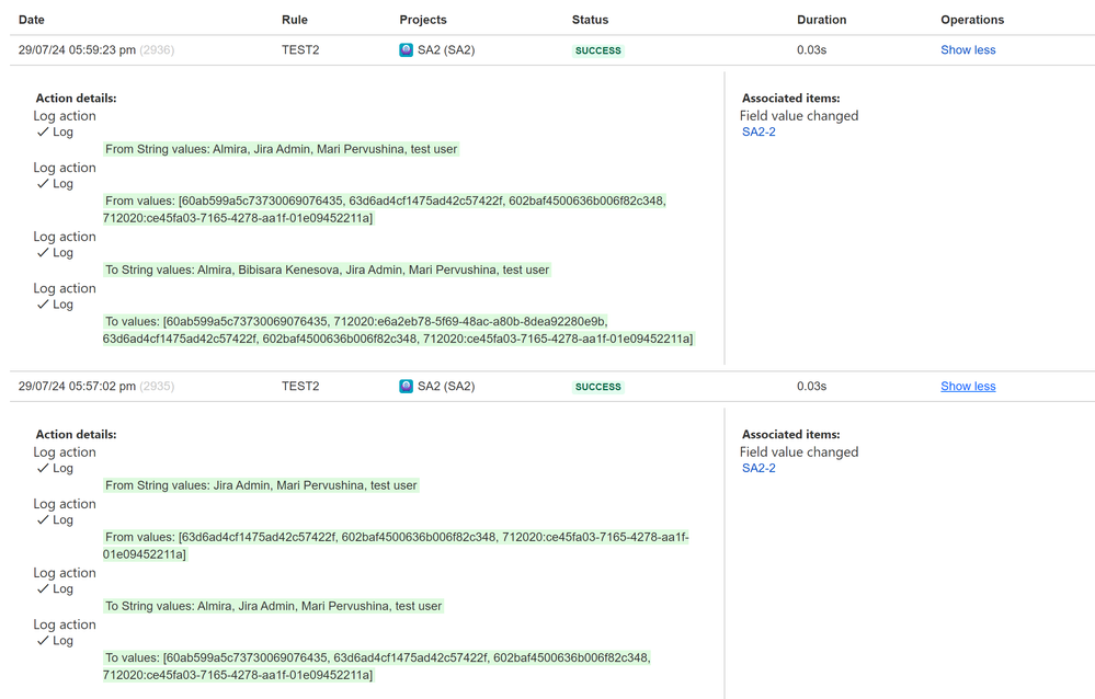

Mari Pervushina
July 29, 2024
Нere are two more field changes. As you can see, the row is inserted according to alphabetical order.

Thanks for that information!  Here are two more tests to confirm the behavior before we try the rule:
GIVEN there are several users selected in the field
WHEN one user is removed
THEN that user is in the from changelog value
AND that user is not in the to changelog value
WHEN all users are removed
THEN all the users appear in the from changelog value
AND no users appear in the to changelog value
Please try those and post the results.

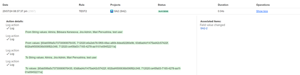

Mari Pervushina
July 29, 2024
1.
Mari Pervushina
July 29, 2024
2.
Did I understand correctly what needs to be done?
Bill Sheboy
July 29, 2024
Thanks, and that confirms the {{fromString}} and {{toString}} may be used to correctly identify the values removed and added by user name.
First to summarize the approach: use the field's changelog values to create lists of the added and removed users, and then use those lists to build dynamic JSON to make changes to the other custom field.

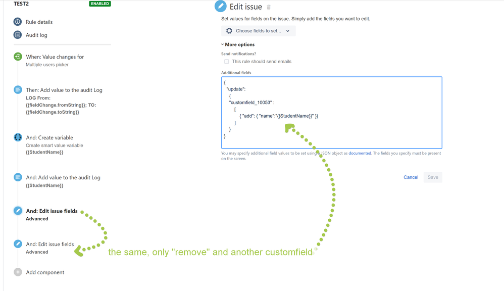

"update: {
"customfield_10048" : [
{{#varAddedUsers.split(",")}}
{ "add": { "name": "{{.}}" } }{{^last}}, {{/}}
{{#if(and(varAddedUsers.isNotEmpty(),varRemovedUsers.isNotEmpty()))}}, {{/}}
{{#varRemovedUsers.split(",")}}
{ "remove": { "name": "{{.}}" } }{{^last}}, {{/}}
This one splits the varAddedUsers on the commas, and adds an entry for each one {{.}} to add it.  Note that this uses the {{^last}} list syntax to dynamically add comm-delimiters, except for the last one.  That is handled with...
Then it checks if both varAddedUsers and varRemovedUsers are not empty so it can add a comma between them.
Finally, it does the same thing for the varRemovedUsers.

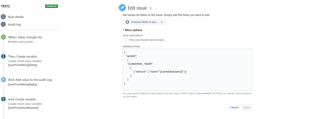

Mari Pervushina
July 31, 2024
@Bill Sheboy
I don't care which users were removed from the field, so I only use the "varAddedUsers" variable. Can I use JSON like this?
"update: {
I'm doing something wrong in this option, as the rule returns the following error "Error while parsing additional fields. Not valid JSON."
Bill Sheboy
July 31, 2024
Do you only want to add the new users?  If so, replace "remove" with "add".
Next, have you confirmed there are users to add before attempting to make the edit?
Finally, to help diagnose this, please write that entire expression to the audit log.  That will help to confirm if there is something invalid in the JSON.

It seems that earlier I made a mistake somewhere in parentheses or commas and now everything is working for me. A piece of code is below in the post
Like Bill Sheboy likes this
Mari Pervushina
August 2, 2024
@Bill Sheboy
Thanks for pointing me in the right direction! I found a solution. It works at Data Center:
"update":
{{#AddedStudents.split(",")}}{"remove": {"name":"{{.}}"}}{{^last}},{{/}}{{/}}

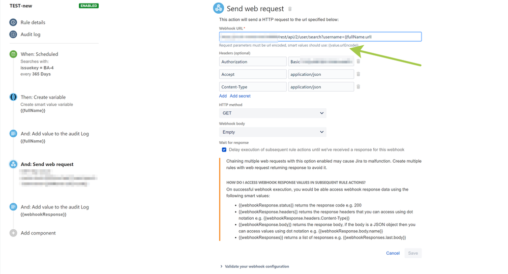

Some users have user name = Full name, I tested it on them and everything was fine. But now I see that my method described above does not work if the user has user name = email. I was thinking of trying to use To/From instead of StringTo/From, but the id part contains ":" and that seems to be the problem. Then I decided to use a webhook request to receive the user name and then work with it. I know how to do this in automation using the standard "Send web request" function and am now looking for a way to do it in a loop.

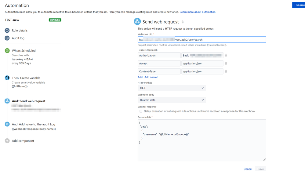

Mari Pervushina
August 6, 2024

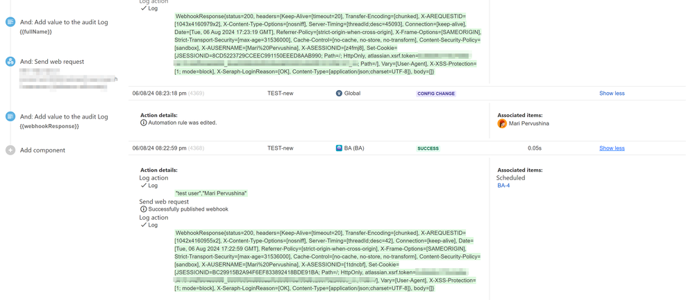

First I try to use custom data. And I have no idea why this doesn't work?
I used this article
https://confluence.atlassian.com/jirakb/how-to-send-a-webhook-from-an-automation-rule-using-assets-object-data-1130372732.html

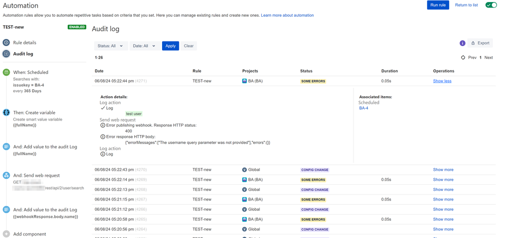

Bill Sheboy
August 6, 2024
Hi @Mari Pervushina
You appear to be calling the Jira REST API endpoint for Find Users.  Is that correct?
https://docs.atlassian.com/software/jira/docs/api/REST/9.13.0/#api/2/user-findUsers
If so, please try passing the query parameters on the URL rather than using custom data.  This one worked for me with Jira Cloud and I suspect it is similar for Data Center.
yourJiraURL/rest/api/2/user/search?query=username="{{fullName}}"

Hello @Bill Sheboy , you are right, this is working. But my plan was to pass the variable not in the url line, but in "Custom data", so that in my case it would be possible to get the username for several users one by one.
Bill Sheboy
August 6, 2024
If the user names are comma-separated values (CSV), this seems to work, probably up to some search limit of 50 users:
yourJiraURL/rest/api/2/user/search?query=username="Alice","Bob","Eve"
And so if your input can be made into a CSV list, with surrounding quotation marks, please try that approach.
Mari Pervushina
August 6, 2024
Query parameters must be transmitted in encoded form. That's why I did it this way. The variable contains a string with fullname. If there is only one name, the request works and returns username. If I pass several values ​​separated by commas, the response body is empty.

Again, I am using Jira Cloud and not Data Center, and so cannot test what I am suggesting...
Perhaps try splitting the values, encoding, and then joining them with commas.

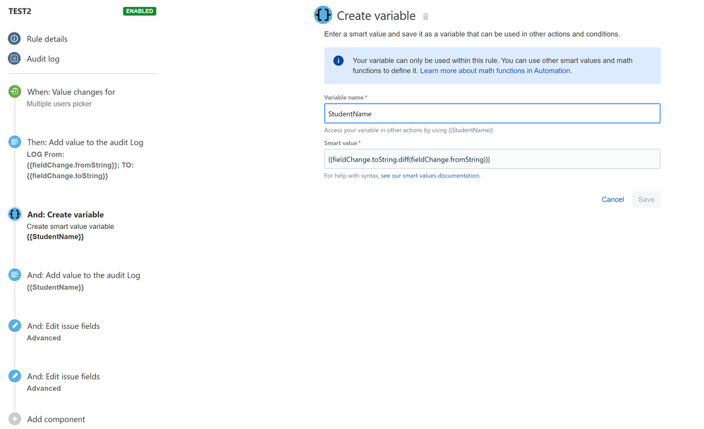

July 29, 2024
I need to get added values for multipl users-picker field, i need the value of difference between From and To as username. My automation bellow.
And the variable StudentName = {{fieldChange.toString.diff(fieldChange.fromString)}} returns Empty, see log bellow.

I understand that the variable {{fieldChange.fromString}} returns a string and it will not be possible to use a minus or a difference here. But I don’t know what I can use.

The diff() function only applies for date and date / time values, and not for text: https://confluence.atlassian.com/automation/jira-smart-values-date-and-time-993924864.html#Jirasmartvaluesdateandtime-diffdiff(date)
