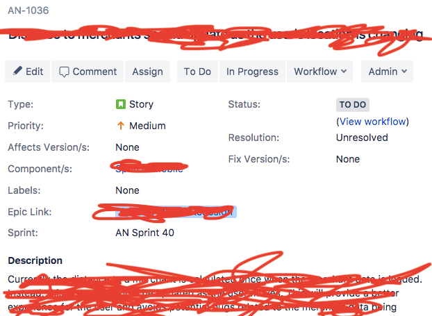

How do I get specific fields to show on the issue view screen?
Jasmine Klecka
January 16, 2018
I can only find how to add fields to the issue edit screen. How do I get these some fields to show on the issue view screen?Screen Shot 2018-01-16 at 2.26.26 PM.png

Nic Brough -Adaptavist-
January 16, 2018
The same way you get them on the issue edit screen - go to the screen that is in use for "view" and add them.
January 16, 2018
Go to project admin and work your way down through the "issue type screen scheme"

Joe Pitt
January 17, 2018
You need to add them to the 'view' screen for the issue type. If you don't have one it uses the 'edit' screen.  start here https://confluence.atlassian.com/adminjiracloud/issue-type-screen-scheme-868982924.html
