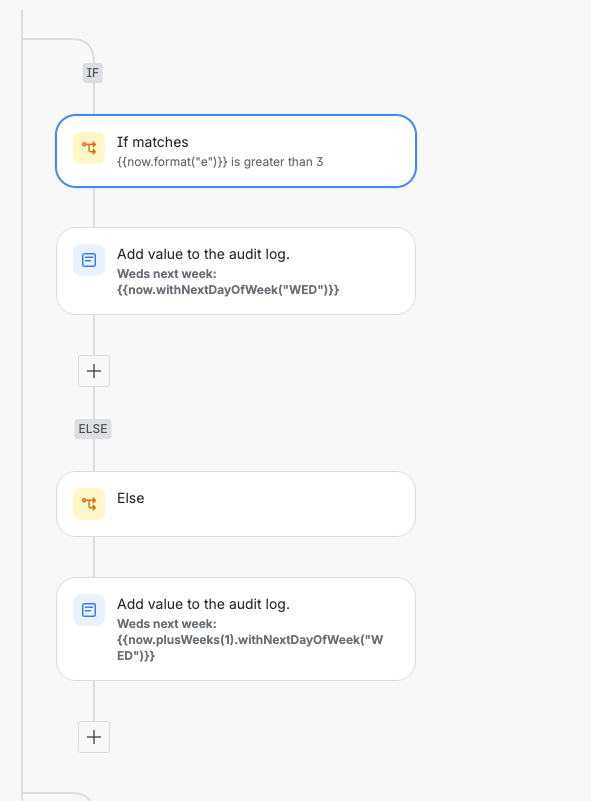

I came up with a solution. It may not be the only solution.
You can use two IF/ELSE blocks to assess what the current day of the week is and from that get the date for the specified day of the week in the next week.
This smart value returns the number for the current day of the week:
{{now.format("e")}}
In my system the week is set to start on Sunday, and the numbers associated with the days of the week are 1 through 7.
The logic for getting the date for Wednesday of next week is then:
If the current day of the week is Weds or later
Then get the date of the next Weds
Else
Add one week to the current date, and then change that date to the Wednesday of that week.
In my example I am using just a Log action to print the results to the rule execution Audit log.

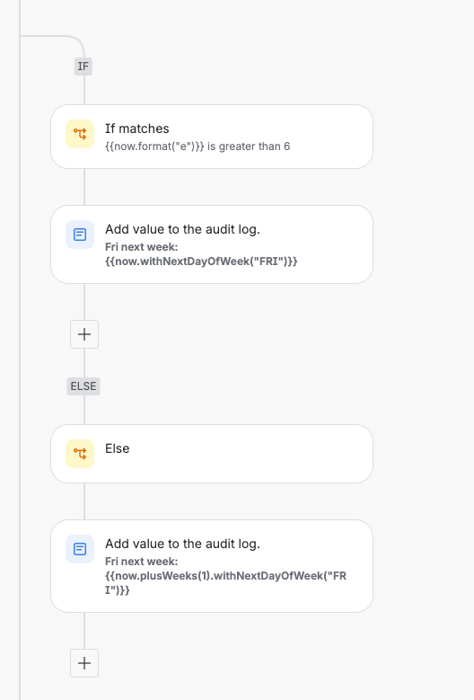

You would use a similar IF/ELSE block to get the date for the Friday of next week.

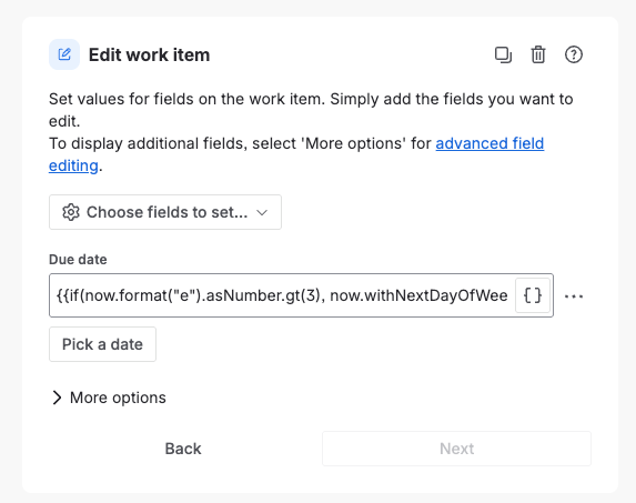

I have the correct syntax for embedding this within a field.
Using Wednesday as the example day of week:
{{if(now.format("e").asNumber.gt(3), now.withNextDayOfWeek("WED"), now.plusWeeks(1).withNextDayOfWeek("WED"))}}
You can use this in a Create action. I used it in an Edit action.
Like # people like this

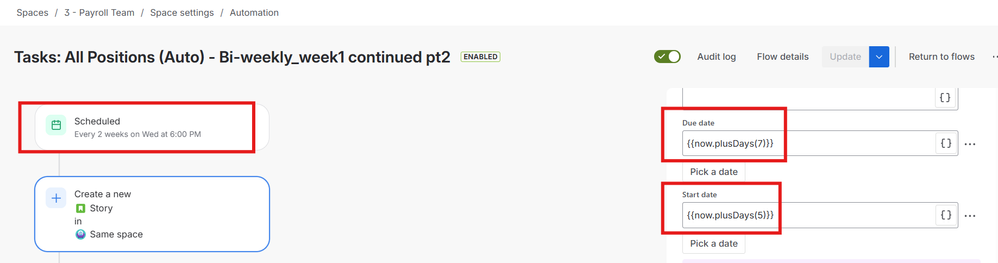

Ganea_ Merissa
May 15, 2026
I used the below workaround, but my fear is if automation ever fails and the fix doesn't happen until the next day, then all of my dates will be wrong. I really want to be able to specify the next week's day of the week for both the start and due date. This pertains to accounting information and any wrong date could mean a payroll delay.
{{now.plusDays(5)}} to get Monday{{now.plusDays(7)}} to get Wednesday
Trudy P Claspill
May 15, 2026
Hello @Ganea_ Merissa
What you showed doesn't match your original requirement:
start date of next week's Wednesday and
a due date of next week's Friday.
With your rule scheduled to run on Wednesday your start date current is set to
Weds + 5 days = next Monday
And your due date currently is set to
Weds + 7 days = next Weds.
Also what do you mean exactly by "if it fails and doesn't get fixed until the next day"? Do you meany you would manually run the rule on a different day of the week than the scheduled run on Weds?
