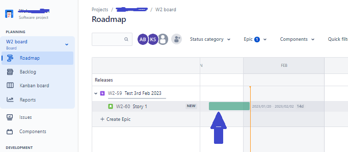

Hi @Norman Shaw
Please confirm if you are looking for the schedule bars on the Stories in your Roadmap view as shown in below screenshot.
If this what you are looking for then you just have to click on the time line column and the schedule bar will appear.
Thank you,
Ashish
