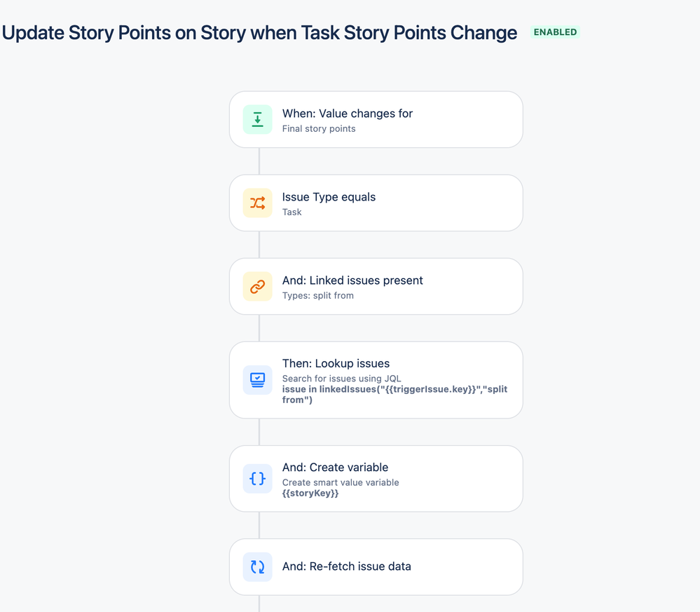

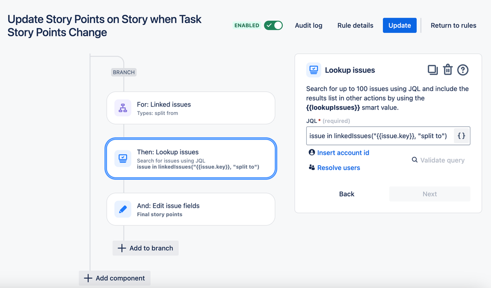

I am not working with a situation that has multiple levels of split issues. It is a pretty standard situation with a story with a few tasks split from the story. I'm not sure if I set up the field incorrectly or the automation but here is what I have for the automation right now but it is not calculating the sum on the story.
I found this automation rule in another Atlassian Community post and adjusted to my particular set up.

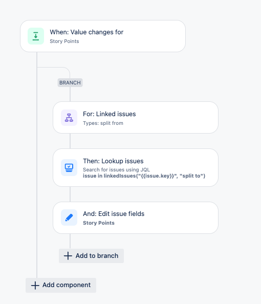

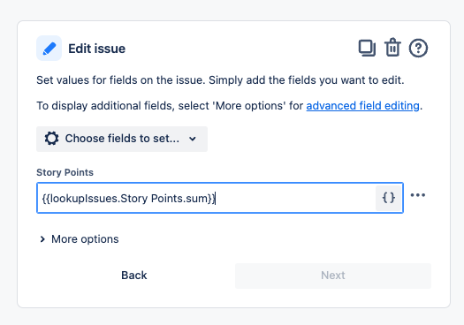

The rule doesn't need to be that complicated.
In my example you would replace Story Points with Final story points

Please show us the rule you created, and the details of each step.

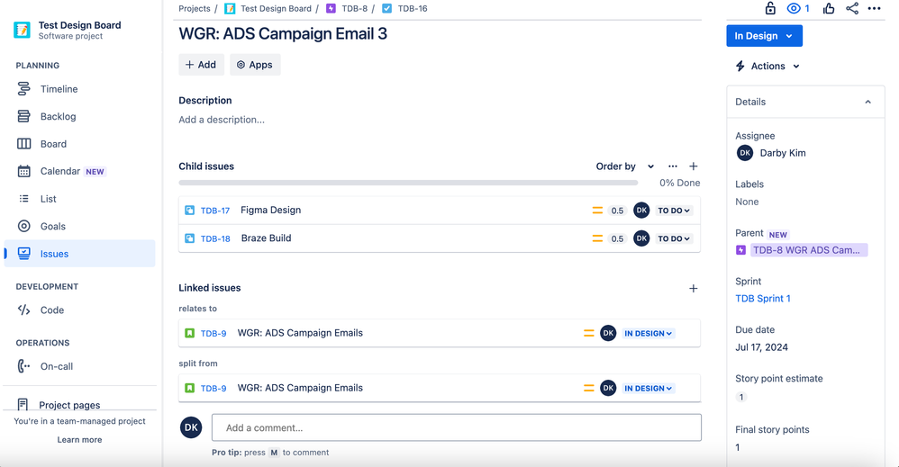

Also please show us the details of the issue where you changed the Final story points value. Show us enough of the image to show us the Final story points field in that issue, and the Linked Issues section showing that it has the "split from" link to another issue.
Also please provide a screen image showing the Audit Log output for the execution of the rule.

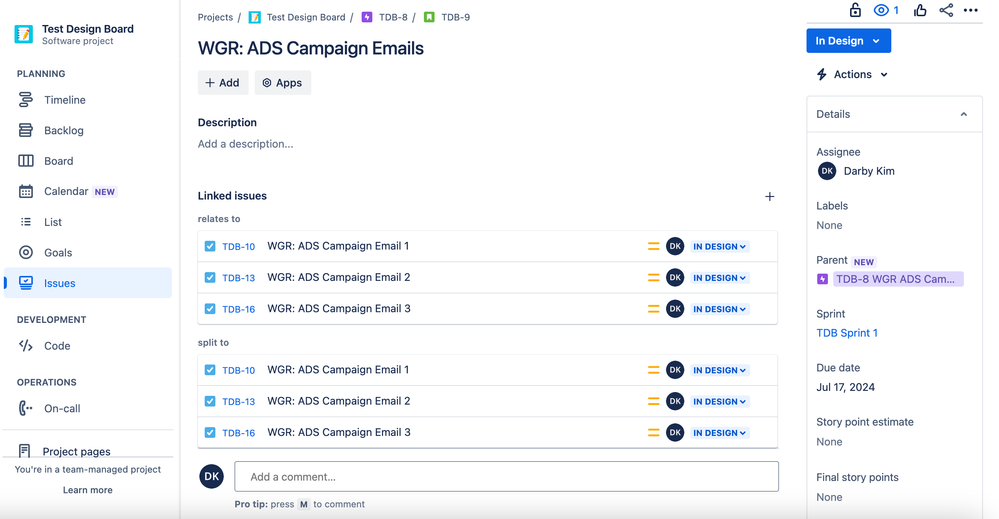

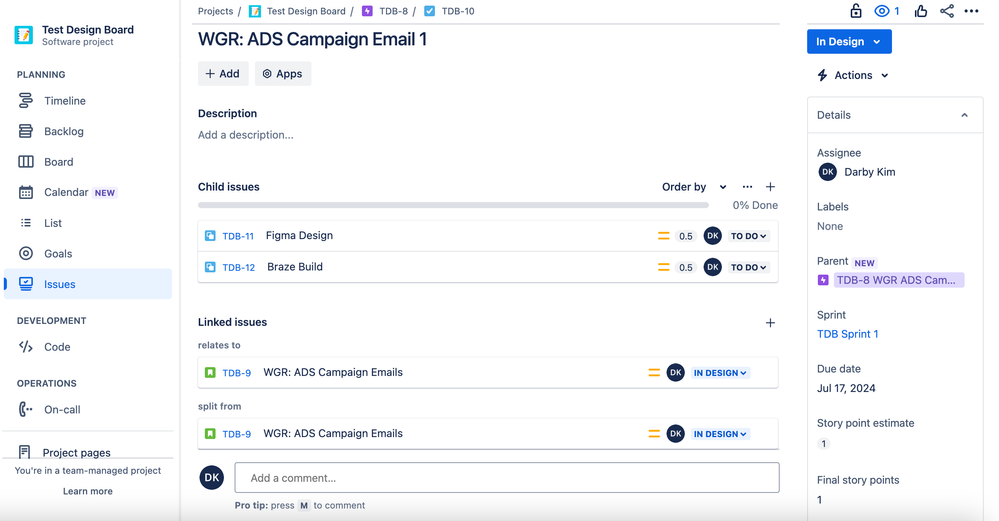

Here are the screenshots of the issues where I am tracking if the automation worked:
Screenshot 2024-07-26 at 11.50.48 AM.pngScreenshot 2024-07-26 at 11.51.09 AM.pngScreenshot 2024-07-26 at 11.51.25 AM.pngScreenshot 2024-07-26 at 11.51.39 AM.png

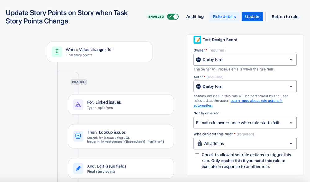

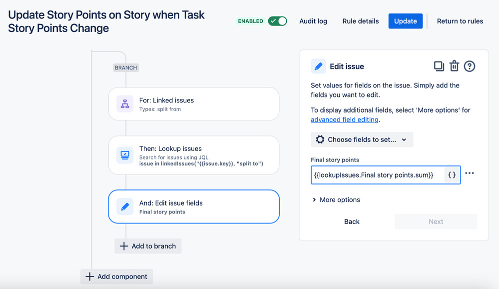

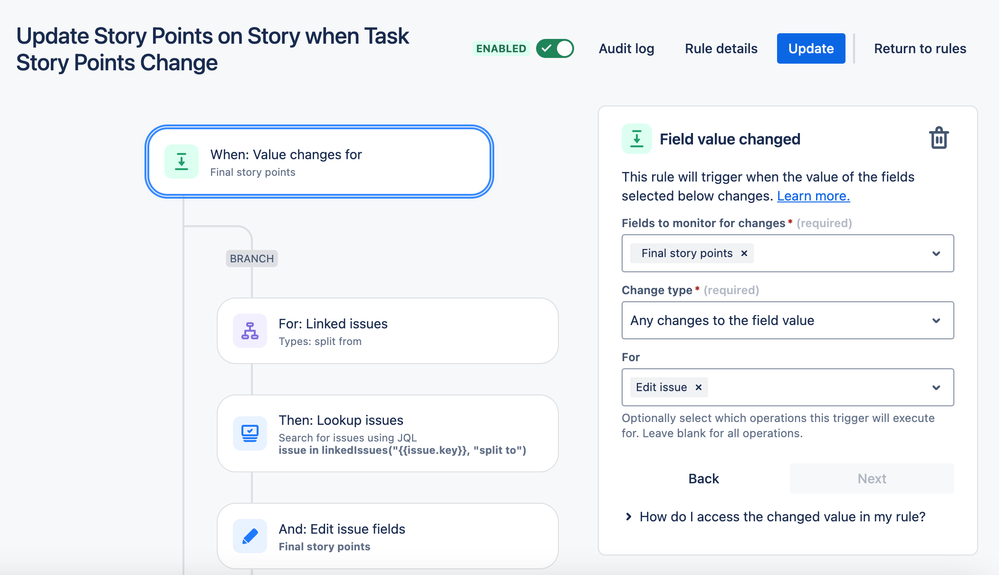

Here are the rule details:
Screenshot 2024-07-26 at 11.34.33 AM.pngScreenshot 2024-07-26 at 11.34.44 AM.pngScreenshot 2024-07-26 at 11.34.56 AM.pngScreenshot 2024-07-26 at 11.35.07 AM.pngScreenshot 2024-07-26 at 11.35.28 AM.png

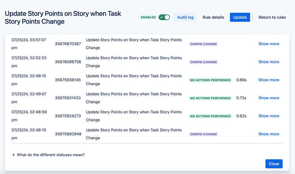

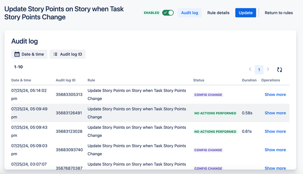

Here is the audit log:
Screenshot 2024-07-26 at 11.36.00 AM.pngScreenshot 2024-07-26 at 11.36.24 AM.png

What is the Scope defined on the Rule Details page and if it is a single project or multiple projects then what projects have you specified as being within scope?

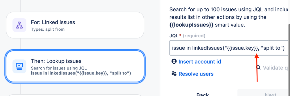

In this step you have a syntax error. You are missing a double quote after the right-curly-braces here.
For this rule to run, you would need to Edit the Final story points field in issues TDB-10, TDB-13, or TDB-16.
In the Audit Log you can see that there are entries that show a status of No Actions Performed. That means the rule was triggered but there was some condition or branch in the rule where the triggering issue didn't match the condition. You can click on the Show more link to the right of those entries to reveal more details. When we ask for the details of the Audit Log for the rule execution, we want those Show more details.
(The status CONFIG CHANGED is an entry for when you have made some change to the rule. Besides No Actions Performed, for entries that are generated by the rule getting triggered you might see statuses such as Success, or Some Errors, or Failed. Refer to this document for more information on the Audit Log.
https://support.atlassian.com/cloud-automation/docs/what-is-the-automation-audit-log/)
After correcting the error in the Lookup Issues action, please make a change to just one of the three issues created from the Split process. Then go to the rule's Audit Log and look for the entry for the execution of the rule and share with us the Show more details.
Darby Kim
July 26, 2024
@Trudy P Claspill Thank you!! The added quotation worked!
