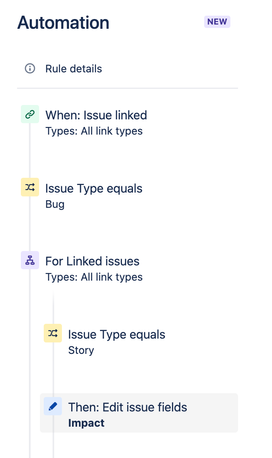

Still, if you really want this, you could set up a workaround with automation. Create a custom field bug count and add it to your story screens. Then, create an automation rule that increases the value of that field by 1 every time a new bug is linked to a story.
That rule may look like this (just replace the impact field with bug count and the appropriate logic to update the field value:
You can then display this custom field on the card view of your issues on the board.

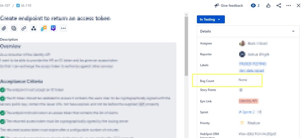

I am fnding that I can now see a bug field on my jira ticket, that I clicked into. I chose text field (view only) for the custom "Bug Count" field.
Is there some script or code I should be adding to this to make it work please?
The filed just says "none" when bugs are linked to the ticket (story or sub task)

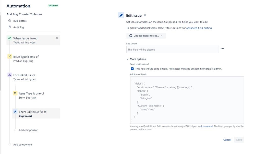

The ticket: -

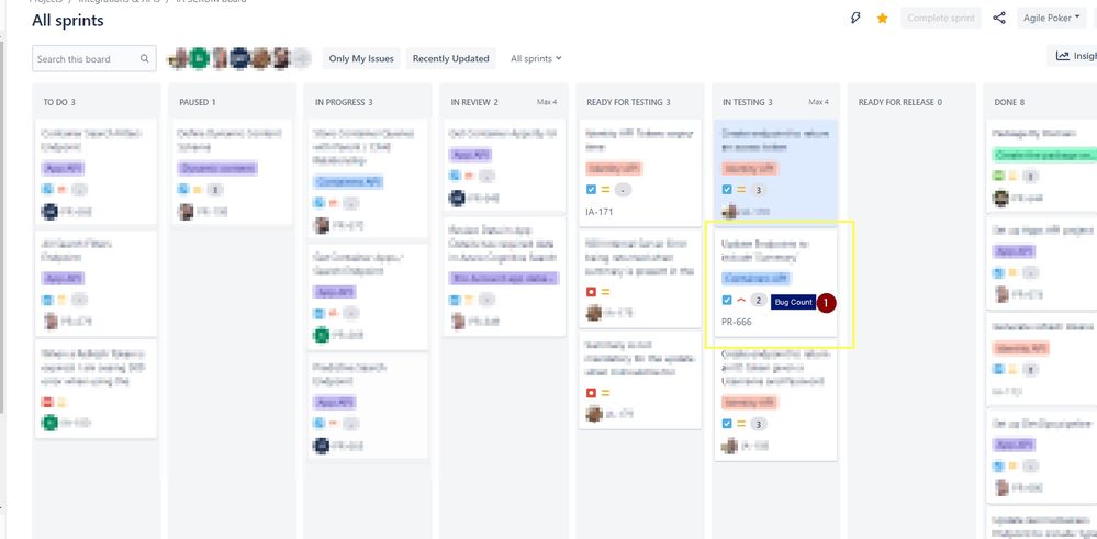

I then want to show this value, once working, on the face of the ticket (example): -

Hi @Mark Nicoll , yes of course. You'll need to tell your custom field to increase its value by 1 each time a new bug gets linked.
You'll need to add this smart value to make it work:
{{#increment}}{{issue.Bug count}}{{/}}

Hey @Walter Buggenhout I have tried the solution - But it did not work - I tried few field type in the custom field and configured the automation as in the picture.
Is there somewhing more I should know or try?
